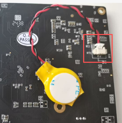

Preparation: One BPI-F3 board and one battery.
Connect the battery to the RTC interface of F3.
Connect the power supply of BPI-F3 and turn on the power to start the device.Connect to the network to obtain real-time time.
After the system is powered on, the RTC will automatically synchronize the system time. You can use commands to query the system time and the RTC time. The system time here is CST time, while the RTC shows UTC time. The difference of 8 hours is within the normal range.

Turn off the power supply and disconnect the network cable. Wait for a while. After powering on again, it was confirmed that the RTC time was operating correctly, but the system time could not be synchronized as the network cable was disconnected.

hyf,
thanks for this guide.
can you tell what type is this battery and voltage
CR2032 button battery,about 240mA. You can also try other batteries with a 1.25mm spacing.
Thank you. This confirms my assumption
