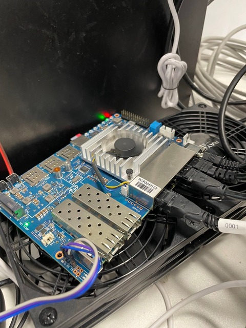

Is the PCIe interface damaged, or is the WiFi NIC itself faulty? I’m online and waiting — could someone please help me?"
Please check if you switched off the 12v power switch for the pcie connector accidentally that is used by the wifi module.
Your bootlog looks like you are usung the old bpi wrt 21.x
Have you tried actual openwrt?
I’ve confirmed that the 12V power supply is turned on, and the 12V green indicator light is also on. I also tried turning the switch off and back on again, but the issue still persists.
I’ve tried both the latest official OpenWrt 24.10 and the OpenWrt 24.10 with the mtk-openwrt-feed patch — both show the same issue.
But pcie and mt76 log (dmesg+lspci) will be more interesting on the mainline/openwrt kernel…
I see some warnings in downstream about link speed i do not know. Not sure how far pcie detection is done.
Do you use heatsinks,fan,case?
I upgraded to OpenWrt 24.10 with the mtk-openwrt-feeds patch. The full boot log is as follows

Previously, it was placed inside a metal case. But for easier debugging, I’ve taken it out.

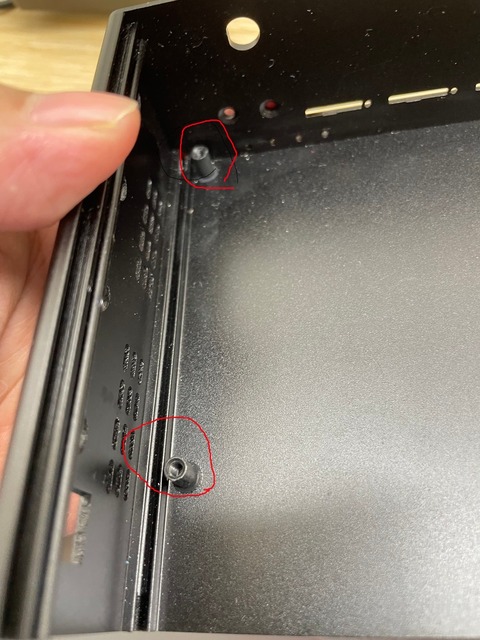

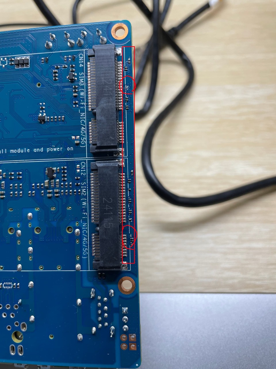

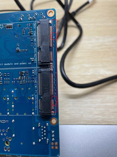

I think I’ve figured out the reason — it’s probably because I accidentally knocked off some components when installing the board into the metal case.
It was likely when I pushed the mainboard in from the side that it got hit by those metal standoffs at the bottom of the metal case, knocking some components off.
