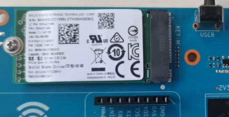

The KEY-M interface of OpenWrt One uses SSD
  1. Prepare a NVME SSD
  2. Connect the SSD to the KEY-M interface on the board.
  1. Start OpenWrt One and by using the command to query, you can see the corresponding storage.
root@OpenWrt:~#
root@OpenWrt:~# lsblk
NAME        MAJ:MIN RM   SIZE RO TYPE MOUNTPOINTS
mtdblock0    31:0    0   256K  0 disk
mtdblock1    31:1    0   768K  1 disk
mtdblock2    31:2    0   512K  0 disk
mtdblock3    31:3    0  12.5M  0 disk
mtdblock4    31:4    0     1M  1 disk
mtdblock5    31:5    0   255M  0 disk
ubiblock0_4 254:0    0  10.3M  0 disk
fit0        259:0    0   4.8M  1 disk /rom
nvme0n1     259:1    0 119.2G  0 disk
root@OpenWrt:~# lspci
00:00.0 PCI bridge: MEDIATEK Corp. Device 1f32 (rev 01)
01:00.0 Non-Volatile memory controller: Solid State Storage Technology Corporation CL1-3D256-Q11 NVMe SSD M.2 (rev 03)
root@OpenWrt:~#
