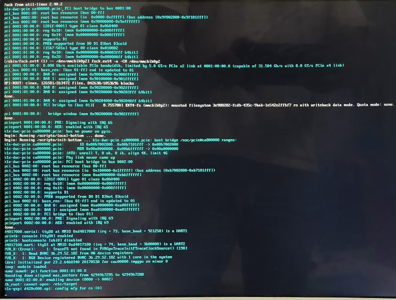

Hello! guys,
Have you guys tested the Debian Image Banana Pi provided? I copied Armbian-bpi-SpacemiT_24.5.0-trunk_Bananapif3_sid_current_6.6.36_xfce_desktop.img downloaded from 百度网盘 请输入提取码 to my Micro-SD card via dd, and tried to boot it, but it seems something crashes.
Can you guys help me?
Thanks in advance!

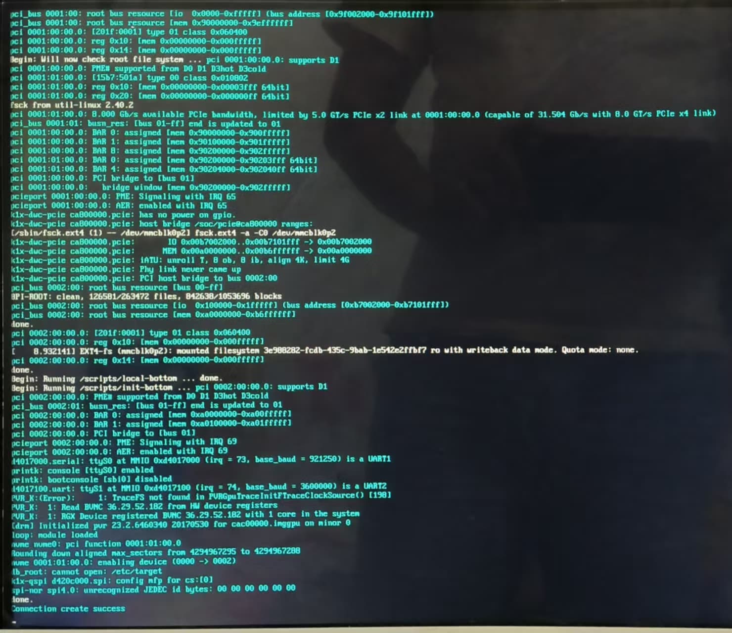

OK! Another Image, Armbian-bpi-SpacemiT_24.5.0-trunk_Bananapif3_sid_current_6.6.36.img.xz can be booted normally! What an amazing SBC!
OK! Guys, If you guys want to boot this Debian Image from NVMe, you can copy (dd) the Image Banana Pi provided to your Micro-SD Card, and boot it, copy the Image (*.img) to your U-Disk, and plug it in your BPI-F3, and copy (dd) the *.img file to NVMe driver, edit /boot/env_k1-x.txt:
And reboot it. (Actually, it just treats /dev/nvme0n1p2 as the root directory, but the read and write speed should be much faster.)
Is it amazing? guys.
