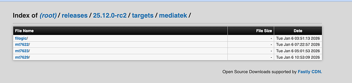

Is there a reason why OpenWRT not put the mt7988 on the releases?
