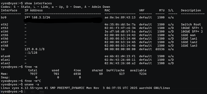

Successfully running VyOS on BPI-R4
Update: Please visit GitHub - KawaiiNetworks/vyos-bpi-r4: VyOS for BPI-R4 for more details.
Because 6.12 has some problems with 6Ghz Wifi, I upgrade the kernel to 6.17.
After several days of effort, I finally succeeded in running Vyos on BPI-R4.
Very nice board :wink:
