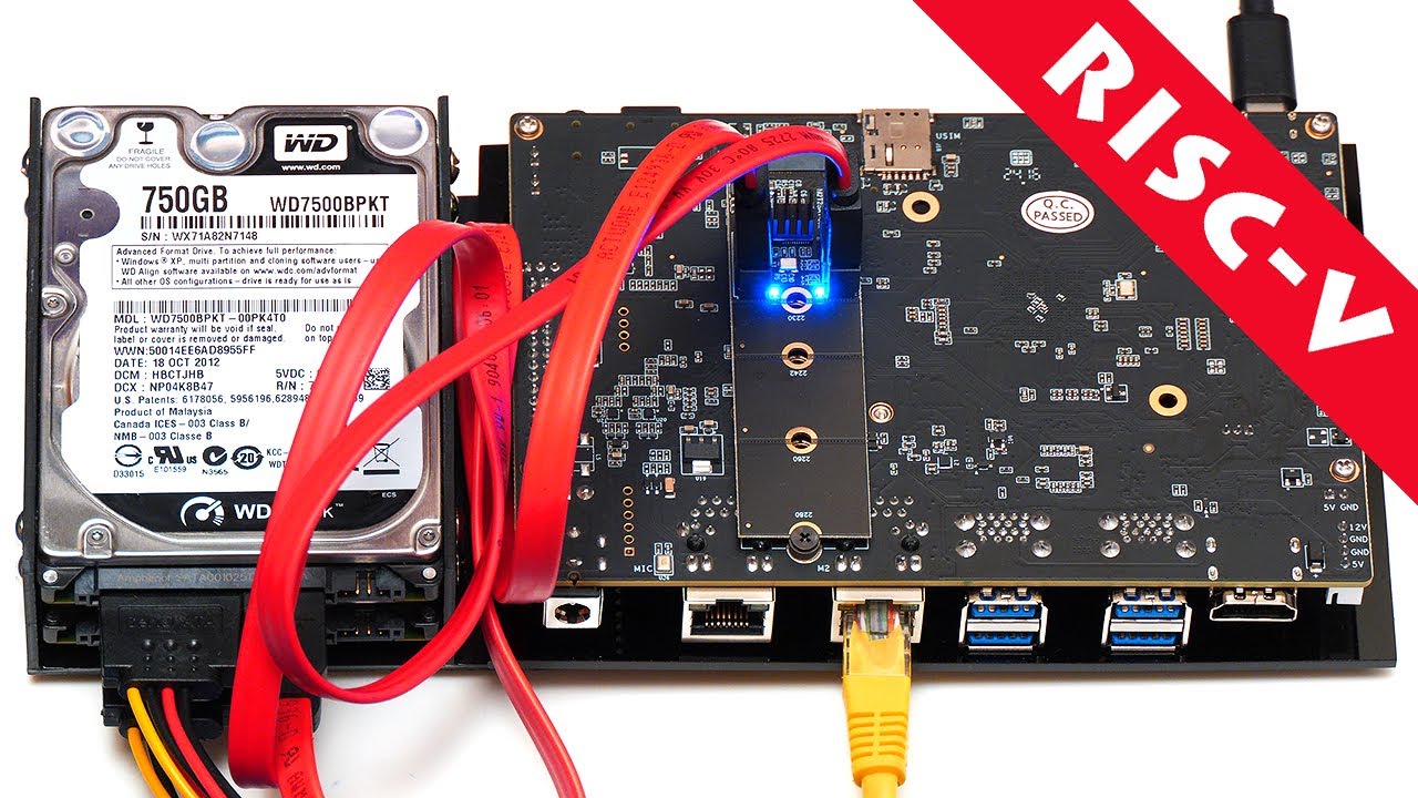

RISC-V NAS: BPI-F3 & OpenMediaVault
BananaPi BPI-F3 Bianbu NASoperating system that includes applications (openmediavault, docker, and common software), frameworks, libraries, runtime, Linux kernel, boot loader (U-Boot), and supervisor interface (OpenSBI).
Bianbu Desktop/NAS image download: Index of /image/k1/version/bianbu
usename&password: bianbu
Hi, I’ve tried to use BPI-F3 as nas but it’s not flexible for that purpose because it has VL817 chip that somehow struggled with external HDDs connected through USB to SATA adapters (jms578 in my case). It just can’t to hold more than two HDDs connected to USB ports on the board, so if I want more than two HDDs I have to add nvme to pci-e adapter and even then I’ll be limited by 4 HDDs at max, but VL817 exposed 4 USB ports, so it will be fair to mention that it can’t work with more than 2 HDDs in the same time . I’ve tested this board with 3 HDDs connected to USB ports and at least one or two are disconnected randomly. Openmediavault which is bianbu-24.04-nas-k1 doesn’t allow me to turn off UAS, so there is no workaround with that, AFAIK.
