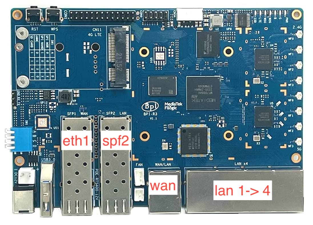

I’ve finish setup iptv through igmpproxy. But when I check with bmon I see eth0 keep sending package

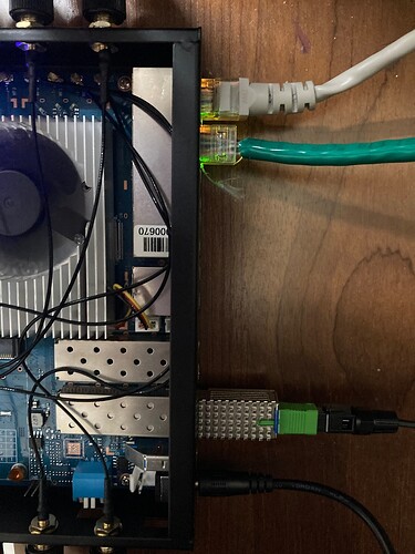

The only port that I plug is eth1, lan3, lan4
So where is port eth0?
eth0 is used internally, it connects to the ethernet switch. Type in a prompt:
ip a
And you will see something like lan1@eth0
