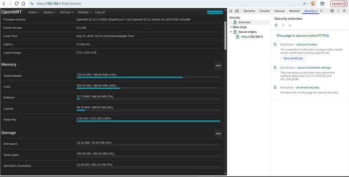

Ok, your router is set up. Now let’s do your browser. Go into the settings, and find the Manage Certificates page (usually under Privacy & Security).
In the browser’s Manage Certificates page, import the luci.crt certificate file which is sitting on your computer’s desktop. You can now delete the luci.crt file sitting on your desktop.
Under System >> Administration >> HTTP(S) Access tab, enable Redirect to HTTPS.

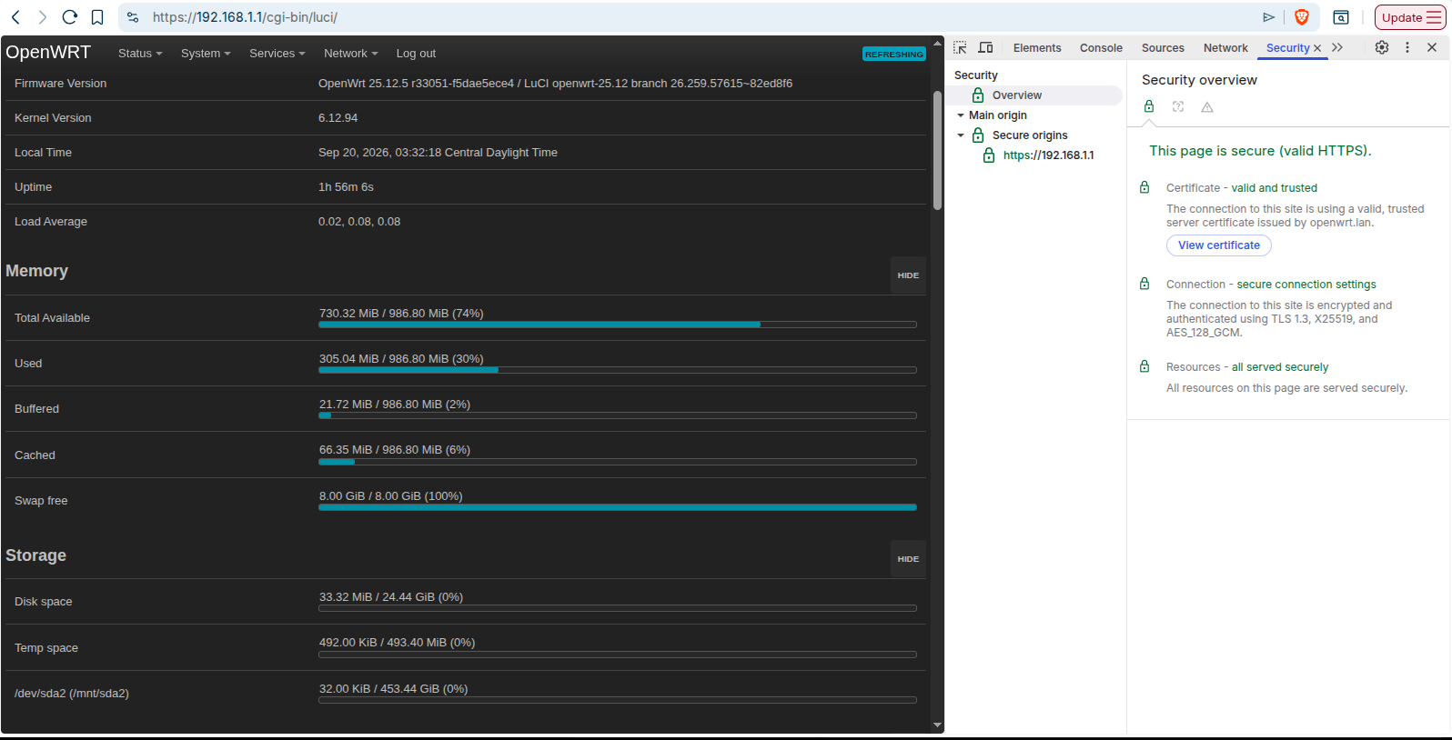

Now navigate to the router via:
https://openwrt.lan
You should see that the connection is no longer flagged as ‘dangerous’ or ‘insecure’.
Now you should be able to just enter:
192.168.1.1
… or…
[fd6a:b132:427f::1] (your IPv6 ULA-Prefix)
… into the address bar… the router will redirect that to HTTPS, and the browser will link openwrt.lan and 192.168.1.1 and your IPv6 ULA-Prefix, and give a green indicator.
You can right-click the page, select Inspect, then near the top, select the >> double-arrows to show more menu options, and select Security.
