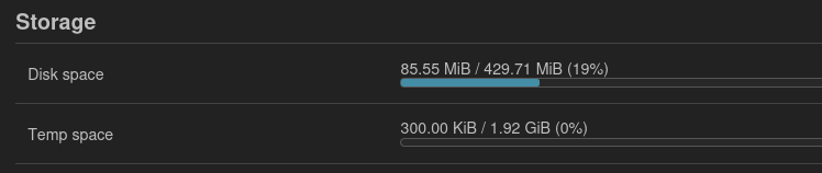

But when I log to Luci, it still show 429MB.

What could be wrong ? Thank you.
I guess,you resized partition but not the filesystem

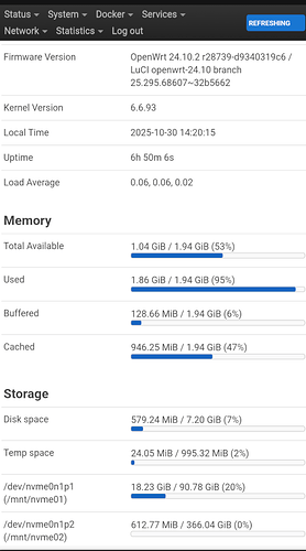

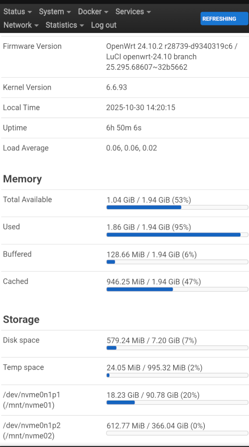

Example
Have you increased filesystem too? Not only partition…
This shot is from a BPI-R3 with OpenWrt 24.10 and a 7,2 GiB emmc partition, extended with cfcdik. Unfortunatey, I don’t know what might happen with BPI-R4.
