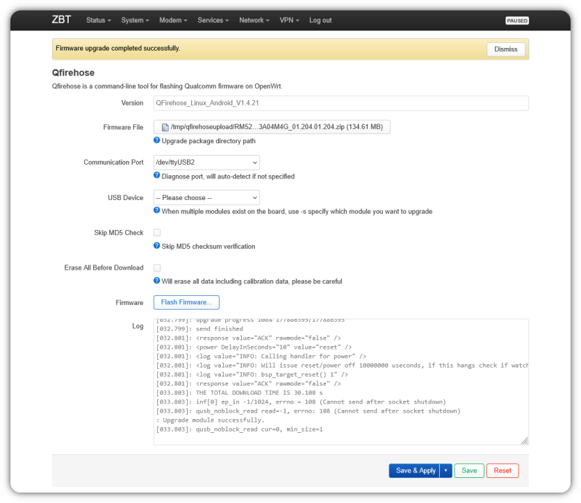

Installing “qfirehose” and flashing Quectel modems easily on OpenWrt thanks to @IceG
  1. The package is here and follow the steps below to install it:
  1. Uninstall or disable “ModemManager”, then reboot the router and also remove or disable the “wwan” interface before flashing the modem:
  1. Guide on how to use “luci-app-qfirehose”:
