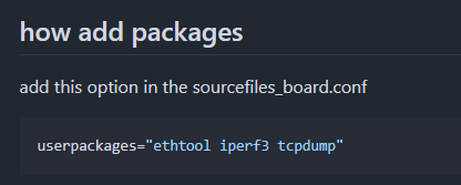

  3. The ubuntu noble image is missing executable such as ifconfig and iwconfig. How can I get them build-in? Is it needed to customize Linux packages or just append from userpackages in sourcefiles_bpi-r3.conf?

Strange,…have you tried the sgdisk fix above?
The fixed gpt images are an older way and should not be used anymore. I create partitions in my uboot repo in mtk_atf_2025 branch via sgdisk as this is more portable and can be adjusted if needed.

Besides, in Images repo, which kind of packages can be added into? For instance, memtester and net-snmp ok?
You are aware that you can install any package, once running from that image? Using:
sudo apt install
The base image is created by atf code after uboot is built. See pipeline above… First compile uboot with device=emmc and then atf with same and run build.sh createimg to ger the base image.
For images repo i meant this
skipubootdownload=1
imgfile=bpi-r4_sdmmc.img.gz
To use the emmc base image.
But basicly you can pass all packages found by apt,but i do not add them by default…only thinking adding basic network packages like ethtool
