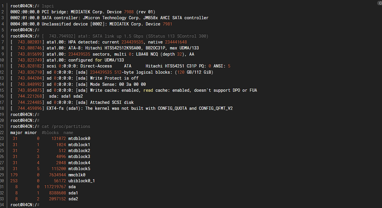

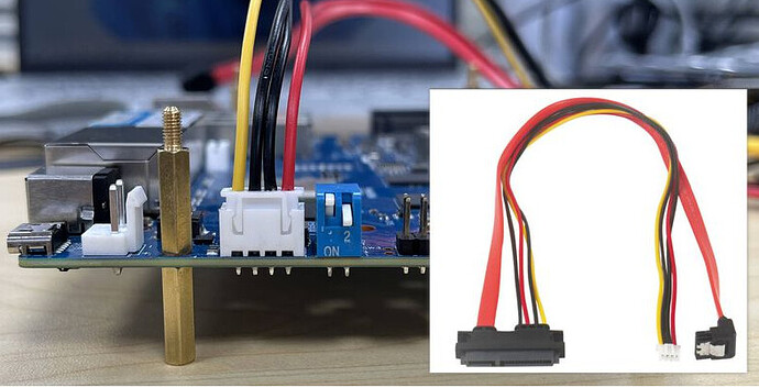

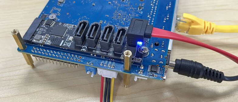

BPI-R4 supports JMicron’s JMB585 (PCIe to 5x SATA chip)
When you plug in the device, you can check by entering lspci and cat /proc/partitions lspci is used to list the PCI devices in the system, while cat /proc/partitions can display disk partition information
