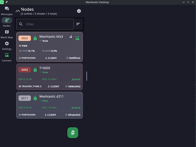

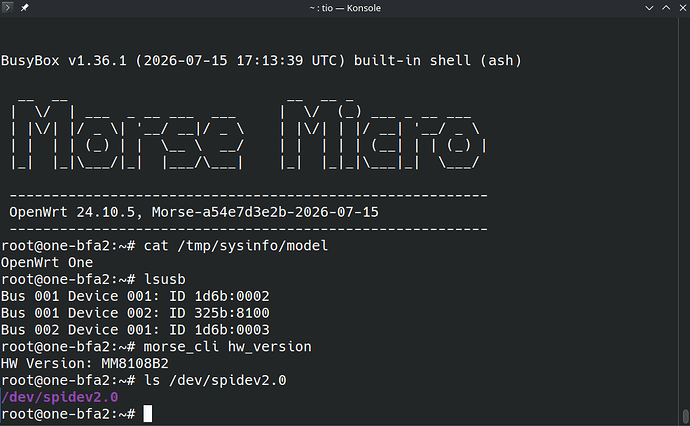

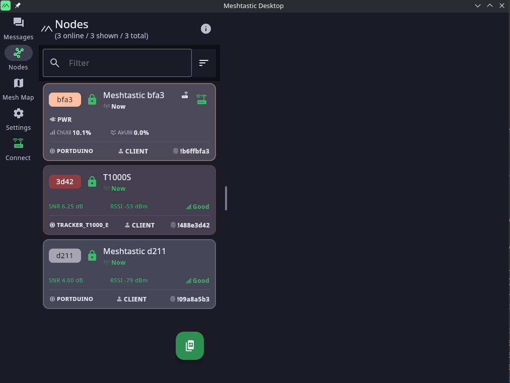

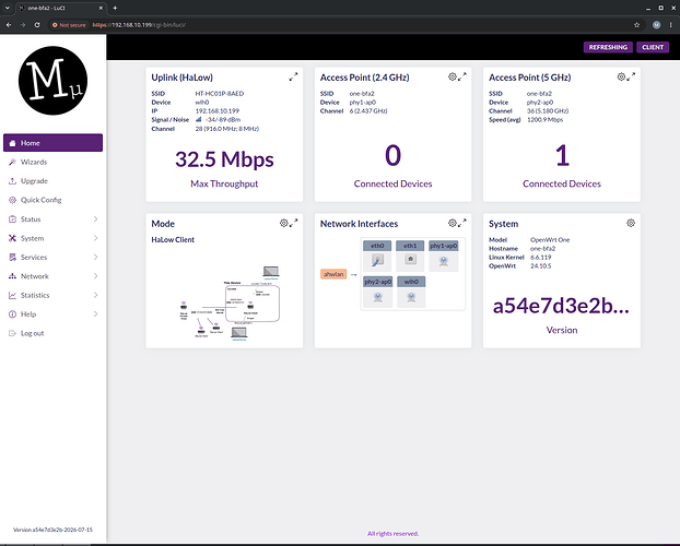

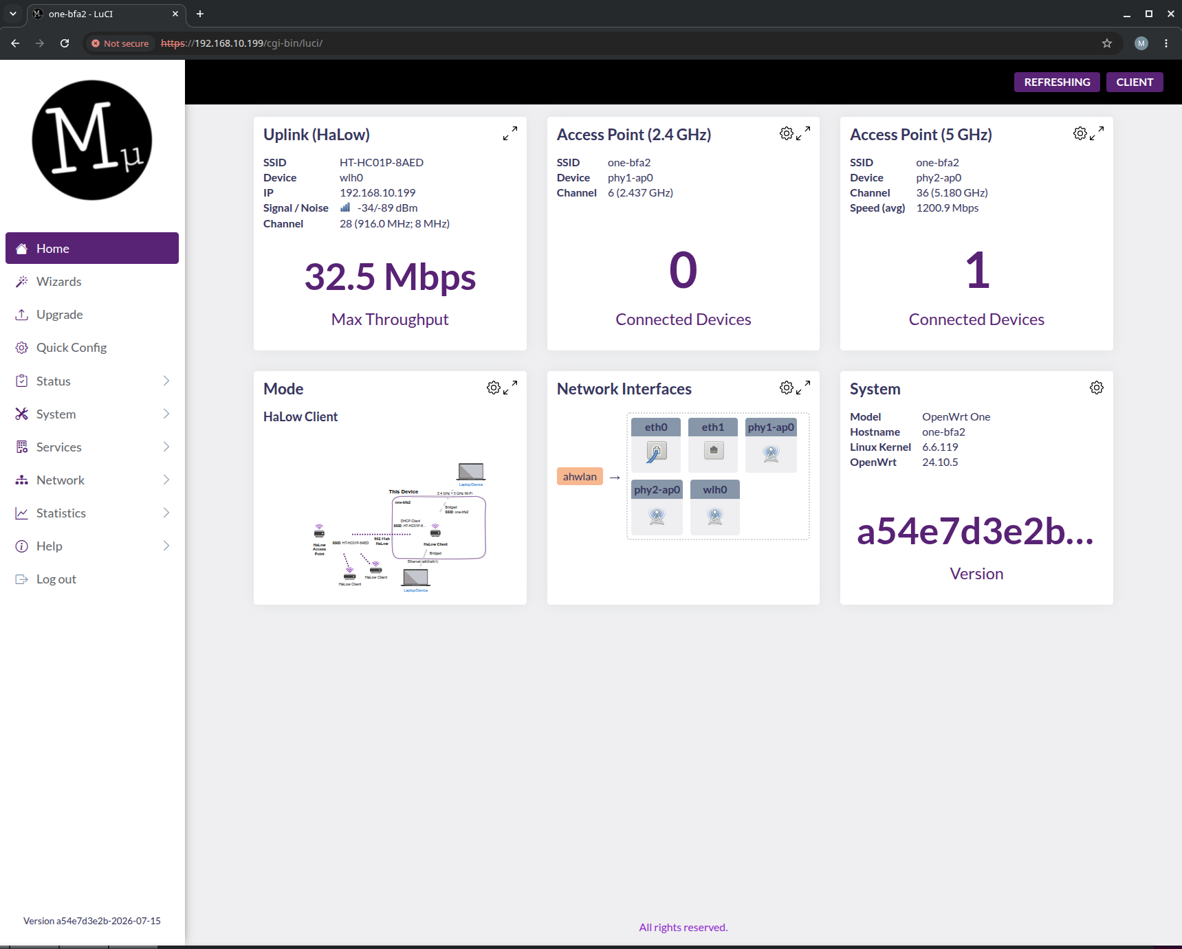

Halow via USB
SX1262/LR1121 via mikroBUS socket /dev/spidev2.0
