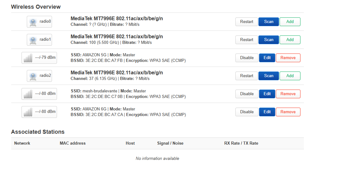

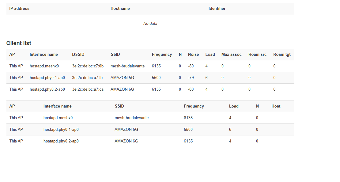

Good morning, I present to you my work, whose main new features are as follows: mesh created for support on all three bands supported by Banana Pi R4, no more duplicated ports, no more “disco” LEDs—LEDs only light up when a cable is connected, and patches and improvements applied directly to OpenWrt. Now, both the LEDs and the system correctly detect and display the status. Please check my README to discover all the features and how it works.

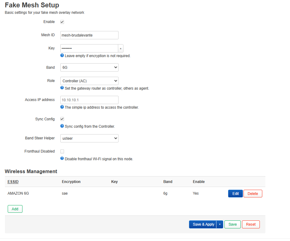

For the wifi stuff he means the fake-mesh package which supports 2g+5g+6g wifi mesh networks.

Good morning, That’s correct; it is for real compatibility with all three bands. That’s why the entire code has been modified, since the Chinese versions are not the same and only work with the 2.4/5GHz bands, and they have no intention of adding the 6GHz band. If I have time today, I will finish the work as I only have a few small details left—it’s 98% done. I just need to confirm that everything works correctly, but since I have kids at home, I can’t leave them without internet, so I have to work on it at night when my health allows. But it will be operational soon. Right now, everything has been removed from my repository because I can’t continue working to finish it, so it is not available. As soon as everything is working 100%, I will put the repository back online again. Good morning.

I honestly didn’t understand the principle of Fake mesh. Is it to combine 2.4, 5 and 6 GHz? And there was one visible wifi network, but in fact it uses the entire frequency range?
