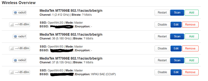

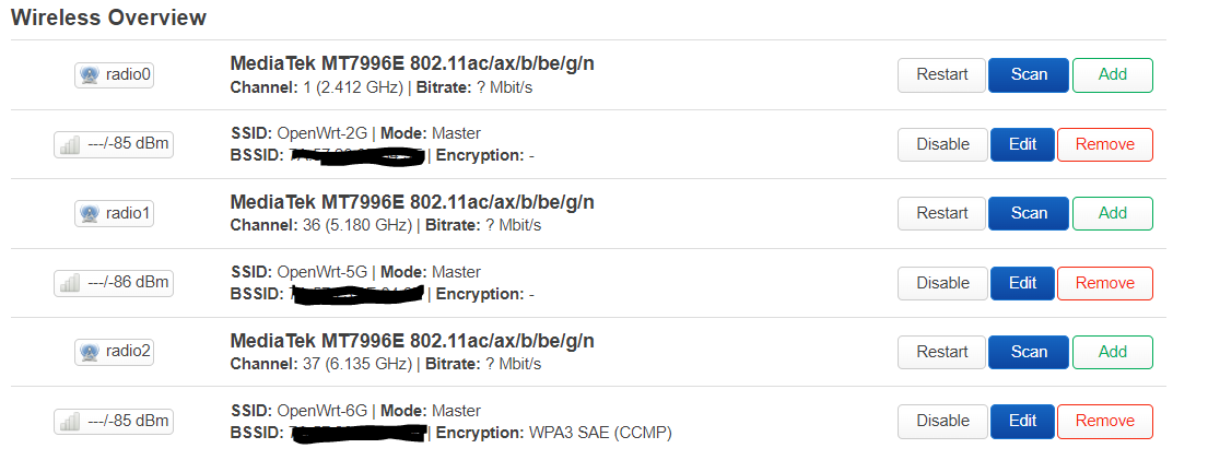

Hi Everyone,
I am new to this scene, I have setup the kit BPI R4 with BE14 WiFi Module, however I can only see 2.4Ghz being broadcasted – I can connect to it but can’t see either 5Ghz or 6Ghz SSIDs I have setup.
I am using the OpenWRT firmware selector for Banana BPI-R4 (snapshot with luci), I had also tried the MTK firmware before (with MTK menu in Luci) but couldn’t get any traction either.
Attaching some screenshots just in case. I noticed lspci returns 7988 while the UI shows the MediaTek as MT996E instead, wonder if that is the issue. Thanks for any feedback/suggestions.
