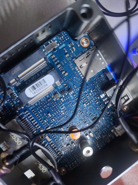

having really tough times sigh now my nand boot through uart is on loop i cant even catch uboot
been fighting with this bad boy for days but its finally up and running on both emmc and nand,
