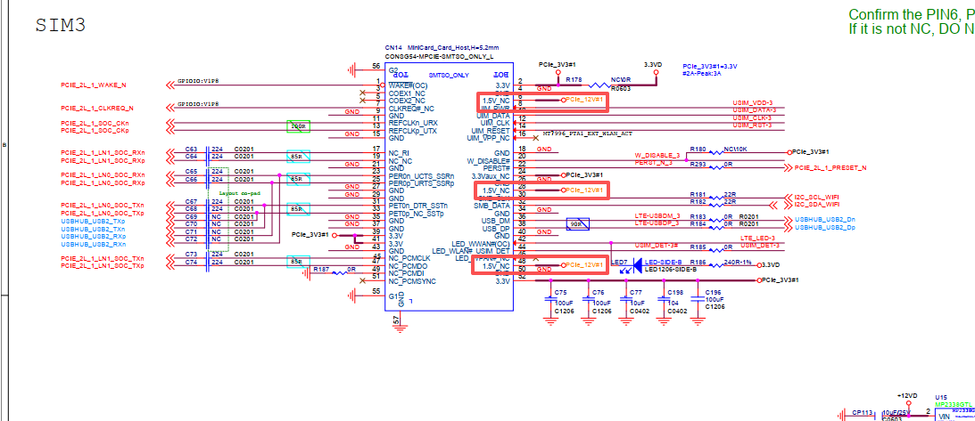

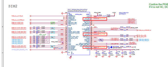

Yep, I found the (seems to be abandoned) Sinvoip’s own project at here: BPI-R4 Accessories : WIFI7 module extension suites
BPI’s adapter board is probably a custom design; it likely involves routing out the 12V power supply separately. In reality, it uses the same interface as the original.
