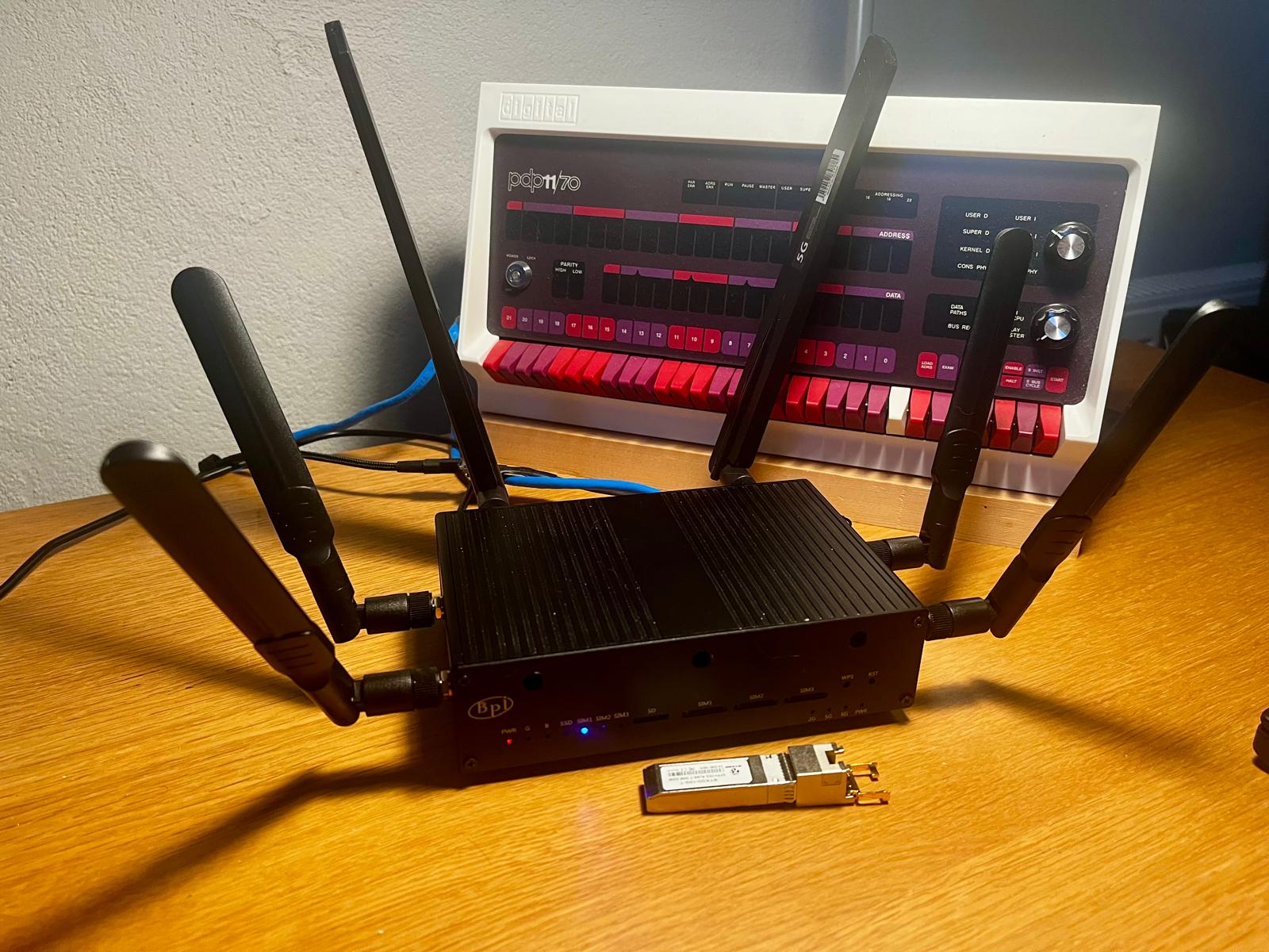

Thanks, and sorry for the late reply. Turns out it works perfectly in CN14 with the mainline driver! Just had to work around the eeprom not being programmed, but no biggie. Now Infix OS runs without a hitch on this BPi-R4 with a Quectel modem and the BPi-MT7615s.
Here’s a write-up on the adventure WiFi on the BPI-R4, From Zero to Two Radios | KernelKit — Home of Infix OS
