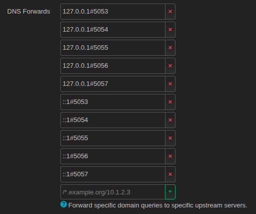

I set up all my IPv4 DoH servers for https-dns-proxy, ensured they were working, then set up my IPv6 DoH servers.
https-dns-proxy sorts the Network >> DNS >> Forwards tab list by reverse order in which the server entry was created… newer entries get shuffled to the top. So now all my IPv6 DoH servers were at the top of the Network >> DNS >> Forwards tab list.
This causes problems… IPv4 DNS queries are delayed by as much as 30 seconds, web pages clock for that amount of time or simply fail to load.
You can go into Network >> DNS >> Forwards tab and manually reshuffle the list to put IPv4 IP addresses back at the top, but as soon as you reboot (or restart the https-dns-proxy service), https-dns-proxy does its thing and puts them right back to the same (wrong) order.
So, I created two scripts to hook into https-dns-proxy, watch for when it makes any changes, then reshuffle the Network >> DNS >> Forwards tab list properly. This works on boot, and when running and you make any changes to your DoH servers in https-dns-proxy.
You can also check that the Network >> DNS >> Forwards tab list is properly sorted, and if not, you can manually trigger the code to properly sort it. Instructions and commands at the end of this post.
This works for any number of configured DoH servers, whether IPv4 or IPv6.
