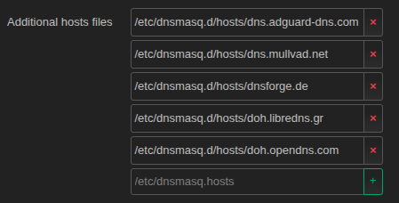

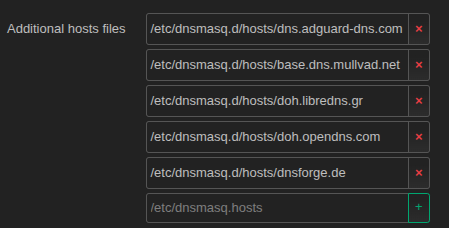

In the LuCI interface, under Network >> DNS >> Resolv & Hosts Files, enter each of those paths to the Additional hosts files setting, then click the + button next to that entry.
Note the grayed-out last entry:
/etc/dnsmasq.hosts
… that’s an example. That file doesn’t actually exist, unless you create it.

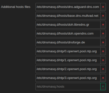

Now paste these into Network >> DNS >> Resolv & Hosts Files >> Additional hosts files list:
/etc/dnsmasq.d/ntp/0.openwrt.pool.ntp.org
/etc/dnsmasq.d/ntp/1.openwrt.pool.ntp.org
/etc/dnsmasq.d/ntp/2.openwrt.pool.ntp.org
/etc/dnsmasq.d/ntp/3.openwrt.pool.ntp.org
… then click the ‘Save & Apply’ button.
