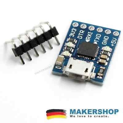

Hi frank, do you have a link for the usb-serial adapter pictured here: 3D designed case for R2 ?
(The plywood case)
it’s a cp21x2
