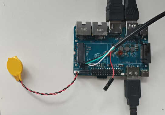

Hardware used:CM6 and A button battery with a 1mm pitch PIN.
Connect the battery interface to the RTC interface of the CM6.
