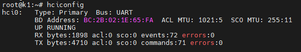

Use the command to query Bluetooth devices
hciconfig

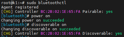

Turn on the Bluetooth function
sudo bluetoothctl    //Turn on Bluetooth debugging
power on                //Open the Bluetooth network card
discoverable on      //Set the controller to discoverable
pairable on        //Set the controller to be pairable

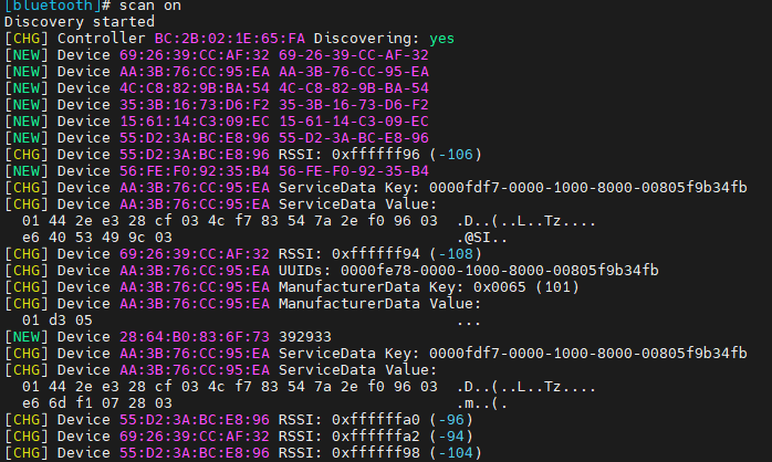

Scan Bluetooth
Use the command to start the scan. If you want to stop the scan, you can also use this command.
scan on              //Scan MAC addresses of other Bluetooth devices
scan off              //Close scanning

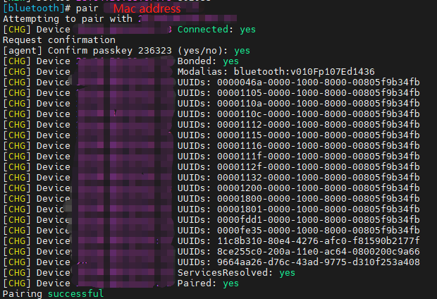

Connect to a Bluetooth device
Use command binding and connect Bluetooth(You can also give it a try with the following other commands)
pair <MAC address>      //Pairing Bluetooth devices

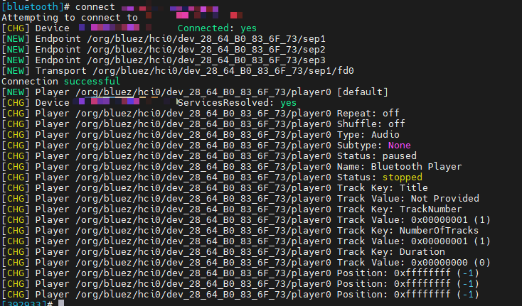

connect <MAC address>  //Connecting a Bluetooth device
exit
Look, you have successfully connected to the Bluetooth device.
