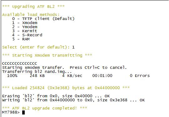

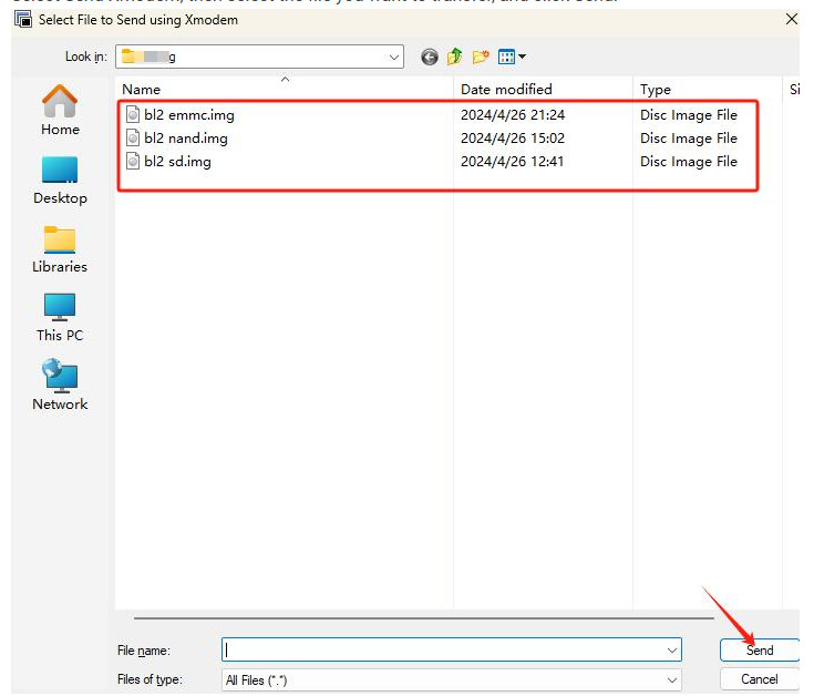

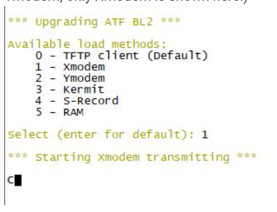

You need to use a serial port utility that can be transferred using Xmodem and Ymodem. (Xmodem operates similarly to Ymodem; only Xmodem is shown here
Select Send Xmodem, then select the file you want to transfer, and click Send
When the transfer is complete, restart the device.

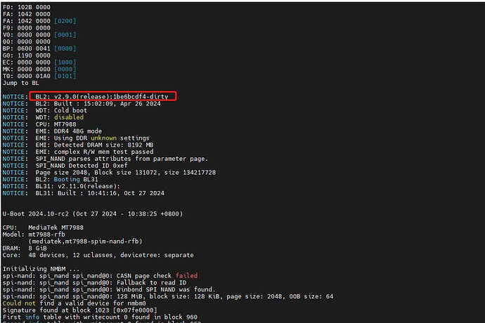

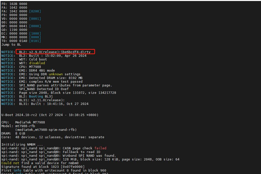

Original bl2 file:

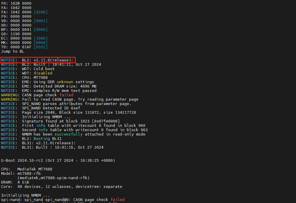

after changing:

Seems that bl2 is downgraded in example…
