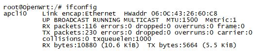

In the debugging serial port to see whether the open interface. image

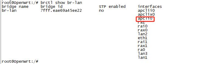

It can be seen that the interface is bridged on the br-lan port and needs to be changed to the br-wan image

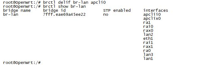

Remove the bridge on the br-lan. image

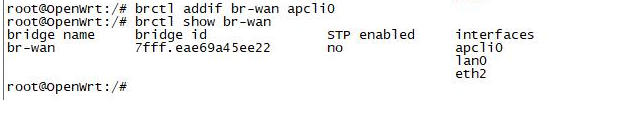

Add bridging on br-wan image

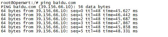

At this point, ping the public network will succeed. image
