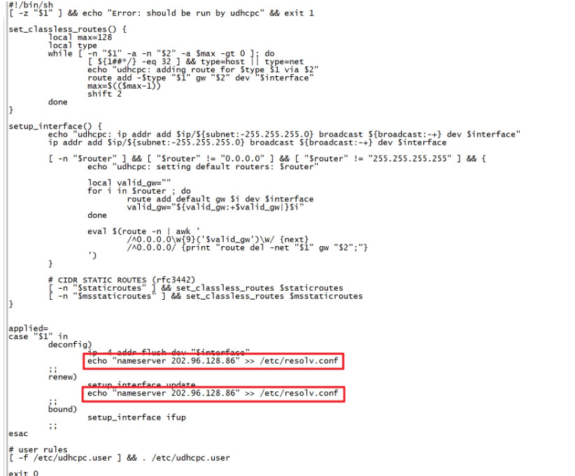

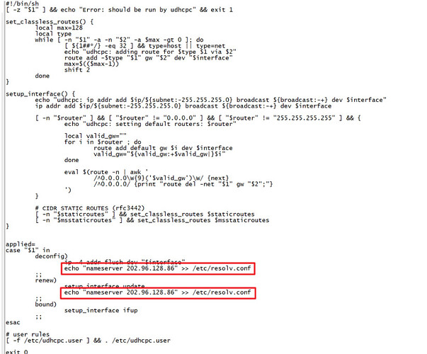

First,manual configuration is required to modify the default.script file via console port.*
Then,Add: echo “nameserver 202.96.128.86” >> /etc/resolv.conf
Modify the IP address according to your local DNS server

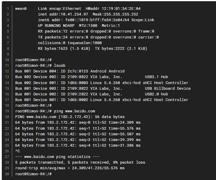

Last,After modifying and setting up, it should be able to successfully ping the internet.
