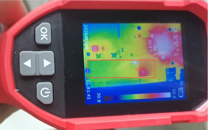

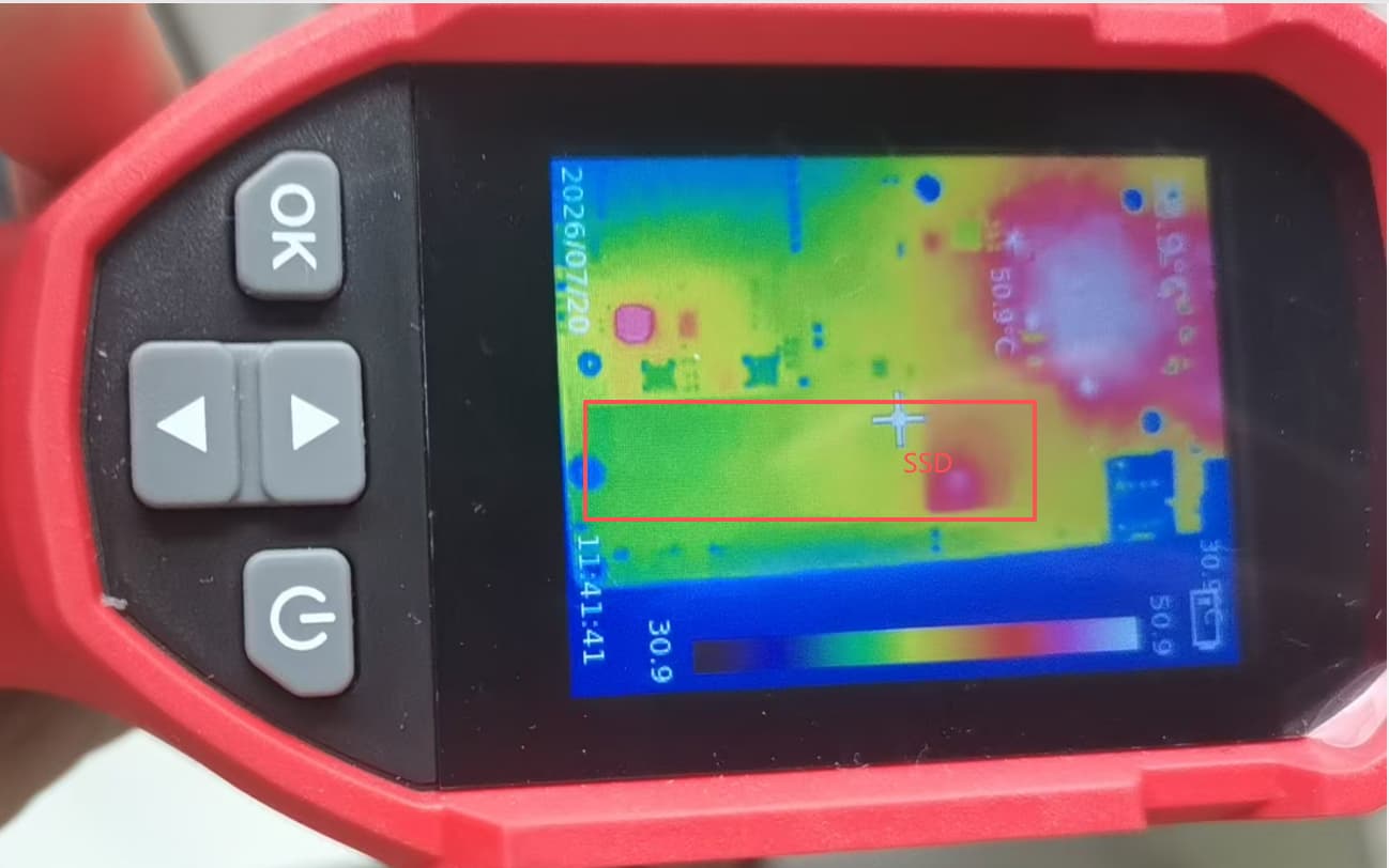

That’s really strange. I’ll try out an R3 later.

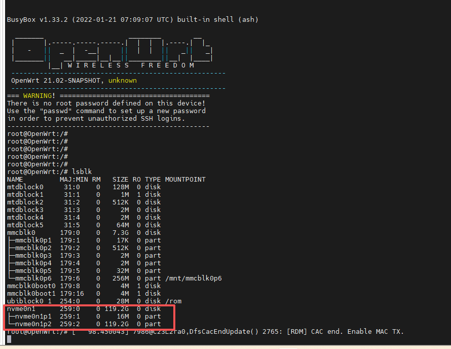

My R3 is using OpenWrt 21.02, but it doesn’t seem to get this hot even when idle.
I’ve left it for a while and it still hasn’t overheated. I’m wondering if it’s a problem with R3? Maybe I should try a different image?
