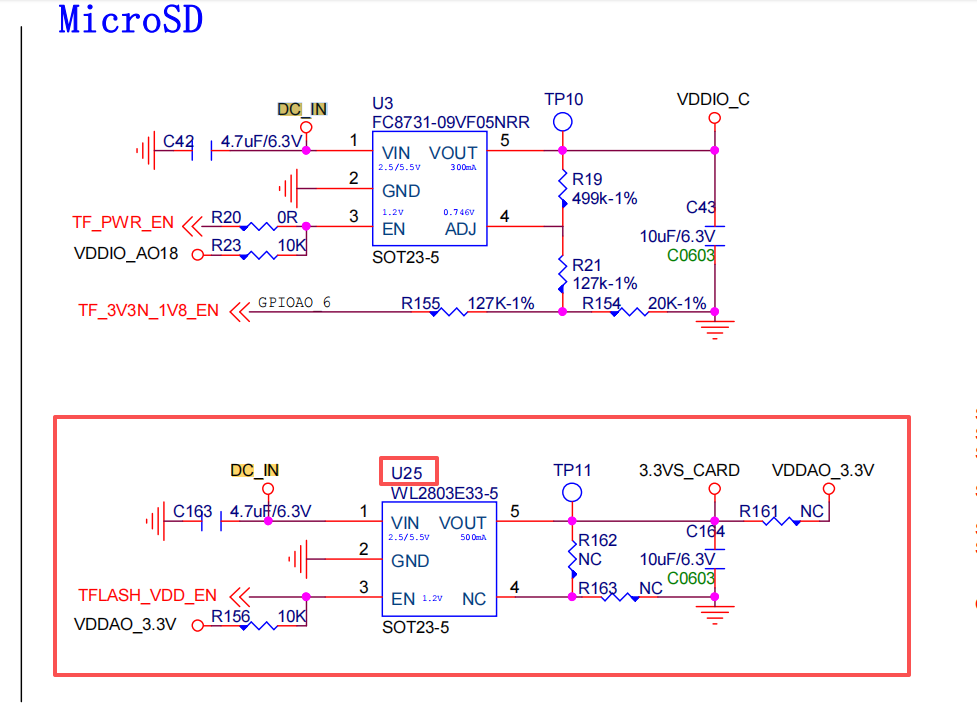

the WS33-2421 chip on my BPI-M5 reaches 75°C and i want to try replace it. does anyone know where to get something which can replace it? thank you

This device is used to power the SD card slot. Could you please check if the voltages VIN and EN are normal?

VIN: 4.62V EN: 0.53V
component faulty? my microSD card stopped working
My measurements show VIN: 5.05V and EN: 3.3V.
This indicates that your chip is not working properly, or it may be faulty.
  1. Is the VDDAO_3.3V power supply normal?
  2. After powering off, please use a multimeter to check if EN and GND are short-circuited.
It seems the chip is burnt out. See if you can buy a replacement online. Before replacing it, please remove the original components and measure EN and GND again to ensure it’s just a chip failure and not a short circuit inside the board.
thank you for your help
