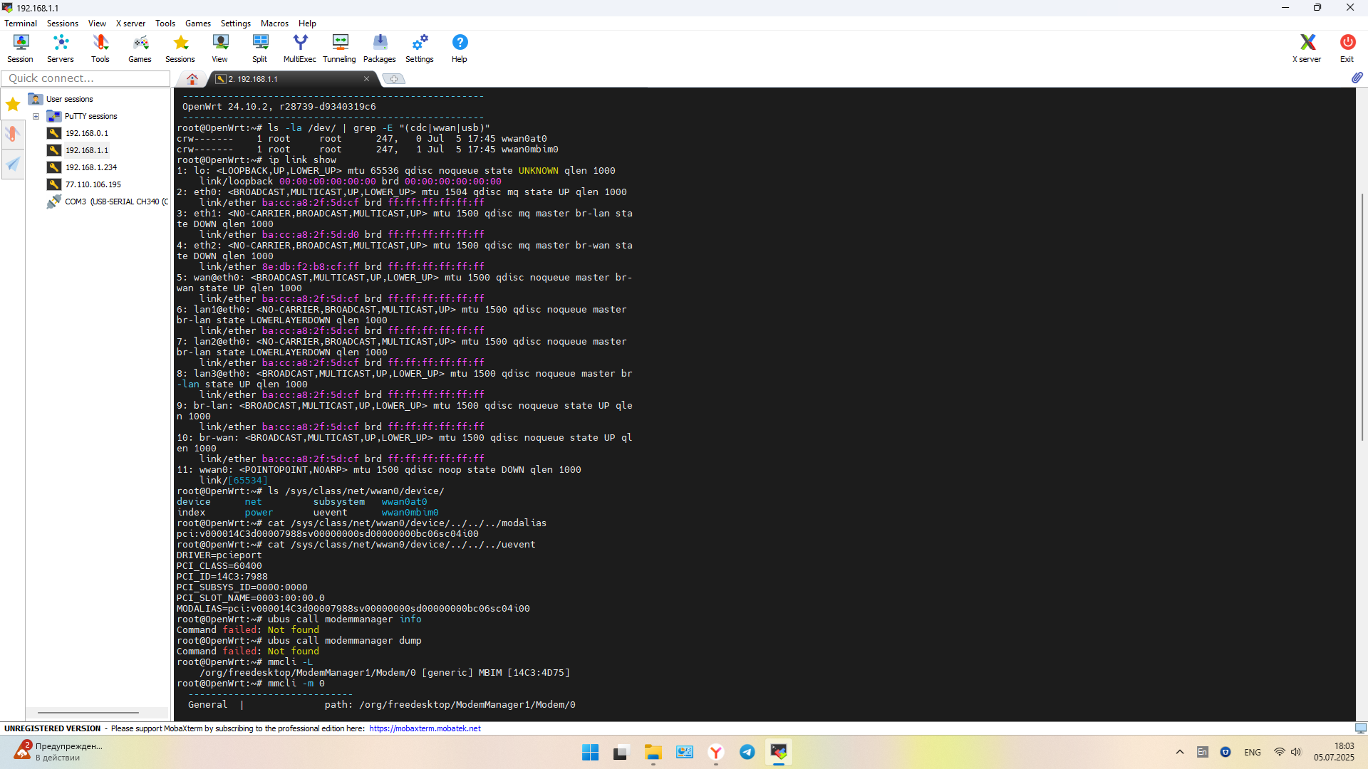

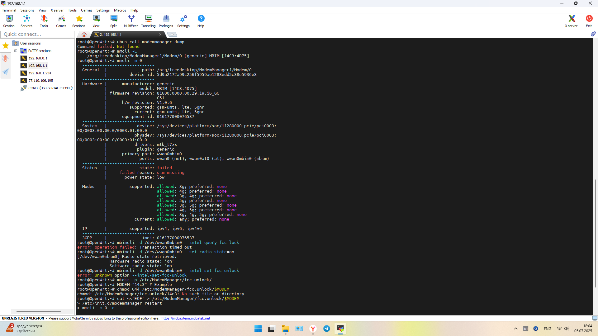

Good afternoon, have you managed to connect the FM 350 modem without compiling the firmware?
Yes, I was able to connect the FM350 modem without compiling the firmware. It worked by following the exact steps and settings I posted above (OpenWrt 24.10.2, ModemManager 1.22.0, kmod-mtk-t7xx, etc.). No custom build was necessary.
Let me know if you need any details.
you couldn’t help me, I’m going to have trouble, and I realized that you need to type commands one by one in the terminal
Actually, it’s pretty simple—just run opkg update && opkg install kmod-mtk-t7xx modemmanager-rpcd luci-proto-modemmanager pciutils mbim-utils and set the UCI configs as shown above. ※ The configuration above uses docomo (Japan) settings, so please make sure to change the APN and other settings according to your own ISP.
To be honest, if you use LuCI (the web interface), it might be even easier for beginners! The hardest part is just opening the terminal in the first place (lol). Once you get past that, it’s almost just copy-paste.
Let me know if you need any help!
root@OpenWrt:~# ls -la /dev/ | grep -E "(cdc|wwan|usb)"
crw-------    1 root     root      247,   0 Jul  5 17:45 wwan0at0
crw-------    1 root     root      247,   1 Jul  5 17:45 wwan0mbim0
root@OpenWrt:~# ip link show
1: lo: <LOOPBACK,UP,LOWER_UP> mtu 65536 qdisc noqueue state UNKNOWN qlen 1000
    link/loopback 00:00:00:00:00:00 brd 00:00:00:00:00:00
2: eth0: <BROADCAST,MULTICAST,UP,LOWER_UP> mtu 1504 qdisc mq state UP qlen 1000
    link/ether ba:cc:a8:2f:5d:cf brd ff:ff:ff:ff:ff:ff
3: eth1: <NO-CARRIER,BROADCAST,MULTICAST,UP> mtu 1500 qdisc mq master br-lan state DOWN qlen 1000
    link/ether ba:cc:a8:2f:5d:d0 brd ff:ff:ff:ff:ff:ff
4: eth2: <NO-CARRIER,BROADCAST,MULTICAST,UP> mtu 1500 qdisc mq master br-wan state DOWN qlen 1000
    link/ether 8e:db:f2:b8:cf:ff brd ff:ff:ff:ff:ff:ff
5: wan@eth0: <BROADCAST,MULTICAST,UP,LOWER_UP> mtu 1500 qdisc noqueue master br-wan state UP qlen 1000
6: lan1@eth0: <NO-CARRIER,BROADCAST,MULTICAST,UP> mtu 1500 qdisc noqueue master br-lan state LOWERLAYERDOWN qlen 1000
7: lan2@eth0: <NO-CARRIER,BROADCAST,MULTICAST,UP> mtu 1500 qdisc noqueue master br-lan state LOWERLAYERDOWN qlen 1000
8: lan3@eth0: <BROADCAST,MULTICAST,UP,LOWER_UP> mtu 1500 qdisc noqueue master br-lan state UP qlen 1000
9: br-lan: <BROADCAST,MULTICAST,UP,LOWER_UP> mtu 1500 qdisc noqueue state UP qlen 1000
10: br-wan: <BROADCAST,MULTICAST,UP,LOWER_UP> mtu 1500 qdisc noqueue state UP qlen 1000
11: wwan0: <POINTOPOINT,NOARP> mtu 1500 qdisc noop state DOWN qlen 1000
    link/[65534]
root@OpenWrt:~# ls /sys/class/net/wwan0/device/
device      net         subsystem   wwan0at0
index       power       uevent      wwan0mbim0
root@OpenWrt:~# cat /sys/class/net/wwan0/device/../../../modalias
pci:v000014C3d00007988sv00000000sd00000000bc06sc04i00
root@OpenWrt:~# cat /sys/class/net/wwan0/device/../../../uevent
DRIVER=pcieport
PCI_CLASS=60400
PCI_ID=14C3:7988
PCI_SUBSYS_ID=0000:0000
PCI_SLOT_NAME=0003:00:00.0
MODALIAS=pci:v000014C3d00007988sv00000000sd00000000bc06sc04i00
root@OpenWrt:~# ubus call modemmanager info
Command failed: Not found
root@OpenWrt:~# ubus call modemmanager dump
root@OpenWrt:~# mmcli -L
    /org/freedesktop/ModemManager1/Modem/0 [generic] MBIM [14C3:4D75]
root@OpenWrt:~# mmcli -m 0
  General  |              path: /org/freedesktop/ModemManager1/Modem/0
           |         device id: 5d9a2172a99c256f5959ae1288edd5c38e5936e8
  Hardware |      manufacturer: generic
           |             model: MBIM [14C3:4D75]
           | firmware revision: 81600.0000.00.29.19.16_GC
           |                    C51
           |      h/w revision: V1.0.6
           |         supported: gsm-umts, lte, 5gnr
           |           current: gsm-umts, lte, 5gnr
           |      equipment id: 016177000076537
  System   |            device: /sys/devices/platform/soc/11280000.pcie/pci0003:00/0003:00:00.0/0003:01:00.0
           |           physdev: /sys/devices/platform/soc/11280000.pcie/pci0003:00/0003:00:00.0/0003:01:00.0
           |           drivers: mtk_t7xx
           |            plugin: generic
           |      primary port: wwan0mbim0
           |             ports: wwan0 (net), wwan0at0 (at), wwan0mbim0 (mbim)
  Status   |             state: failed
           |     failed reason: sim-missing
           |       power state: low
  Modes    |         supported: allowed: 3g; preferred: none
           |                    allowed: 4g; preferred: none
           |                    allowed: 3g, 4g; preferred: none
           |                    allowed: 5g; preferred: none
           |                    allowed: 3g, 5g; preferred: none
           |                    allowed: 4g, 5g; preferred: none
           |                    allowed: 3g, 4g, 5g; preferred: none
           |           current: allowed: any; preferred: none
  IP       |         supported: ipv4, ipv6, ipv4v6
  3GPP     |              imei: 016177000076537
root@OpenWrt:~# mbimcli -d /dev/wwan0mbim0 --intel-query-fcc-lock
error: operation failed: Transaction timed out
root@OpenWrt:~# mbimcli -d /dev/wwan0mbim0 --set-radio-state=on
[/dev/wwan0mbim0] Radio state retrieved:
             Hardware radio state: 'on'
             Software radio state: 'on'
root@OpenWrt:~# mbimcli -d /dev/wwan0mbim0 --intel-set-fcc-unlock
error: Unknown option --intel-set-fcc-unlock
root@OpenWrt:~# mkdir -p /etc/ModemManager/fcc.unlock/
root@OpenWrt:~# MODEM="14c3" # Example
root@OpenWrt:~# chmod 644 /etc/ModemManager/fcc.unlock/$MODEM
chmod: /etc/ModemManager/fcc.unlock/14c3: No such file or directory
root@OpenWrt:~# cat <<'EOF' > /etc/ModemManager/fcc.unlock/$MODEM
> /etc/init.d/modemmanager restart
> mmcli -m 0 -e
> mbimcli -d /dev/wwan0mbim0 --query-radio-state
moderated: please use code-tags for better readability
root@OpenWrt:~# ubus call modemmanager info Command failed: Not found root@OpenWrt:~# ubus call modemmanager dump Command failed: Not found
These failures occur because ubus isn’t installed. Install it with:
opkg update && opkg install ubus
I had forgotten to include the ubus package in the image. My board revision is 1.1. The main difference between our setups is the firmware revision. On your system, the SIM card wasn’t recognized at first. After some trial and error with the interface settings, it began working. On my system, I got it working by setting:

It seems that the modem successfully establishes a connection, but then a kernel panic occurs afterwards. Is the power supply voltage sufficient? For reference, I am using a PC-VP-BP143 AC adapter, as described here:
It still exhibits kernel panic using this card in pcie mode using the latest software packages.
Please try removing sing-box.
 OpenWrt 24.10.2, r28739-d9340319c6
