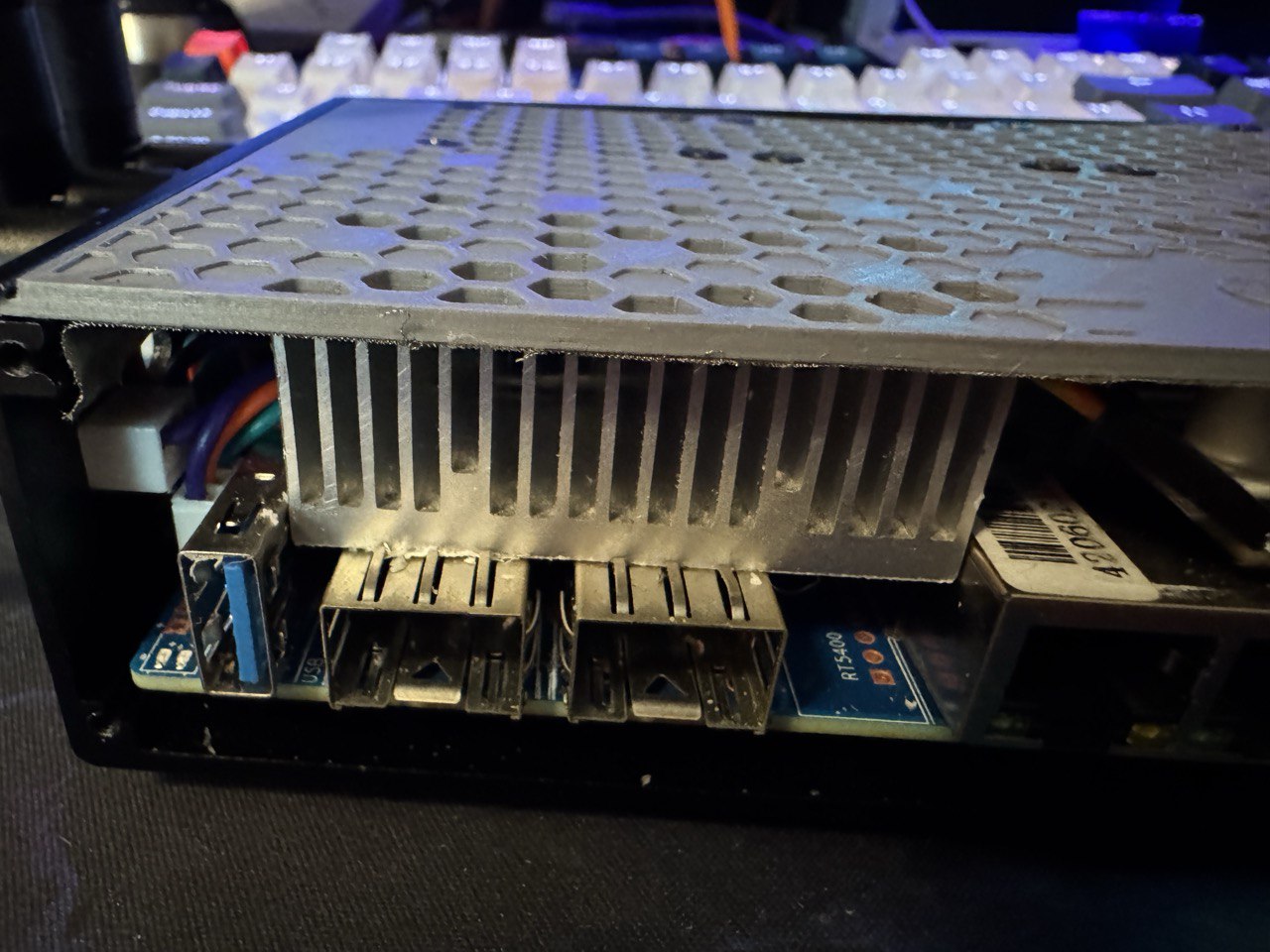

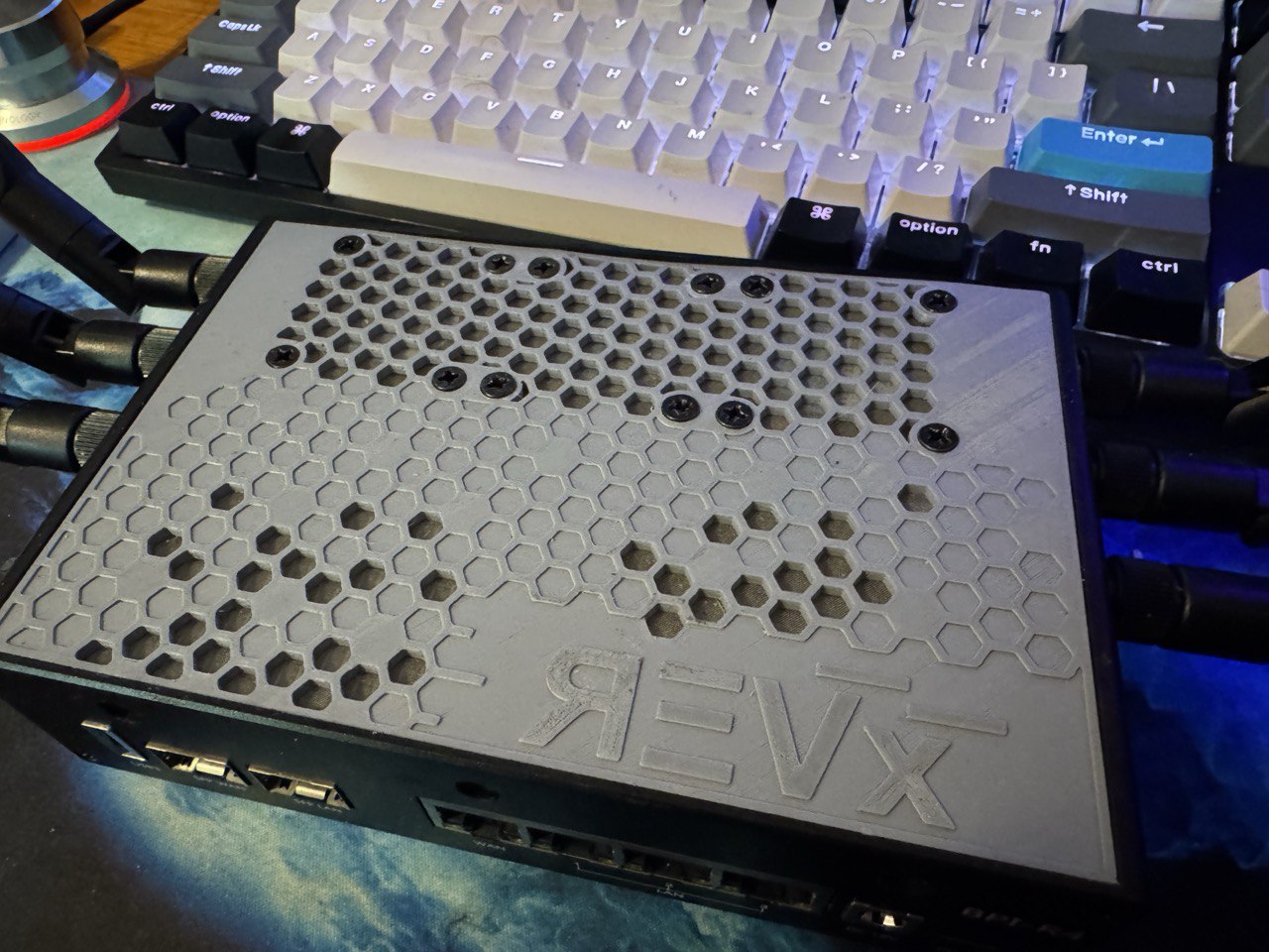

I hear that a-lot, that this thing runs hot. I either haven’t stressed it enough, which is very likely right now, or I did a decent job prepping. I swapped out all the thermal pads with higher quality ones and figured I’d spend the time waiting on my new WiFi cards working on the cooling. Had a little too much fun with it.
  • Added NVMe heatsinks directly below the WiFi card day one.
  • Heat sink from an old motherboards north bridge for the SFP cage. Oddly satisfying fit.

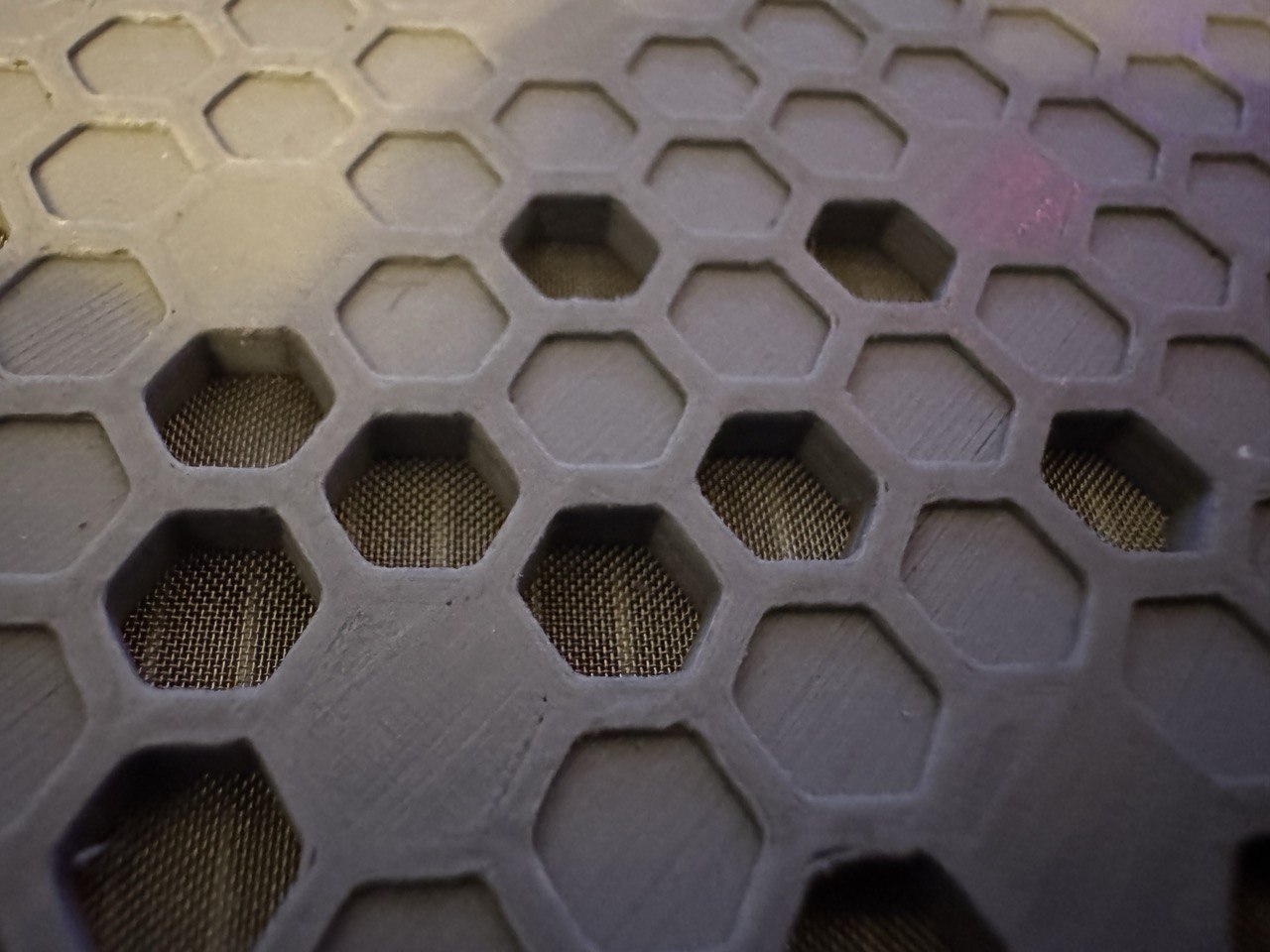

  • Then came the 3D printing. Custom designed top cover with three 40mm fans. The 12v Winsinn fans from Amazon actually move a decent amount of air, used a small buck converter to keep the fan noise down. Intentionally choked a majority of the airflow on the top, to force air to come in the side vents by the WiFi card.
  • For good measure I added some steel mesh to the bottom of the cover and ensured it comes in contact with the sides of the aluminum casing.
Your top cover looks great - any chance to have it published for download anywhere?
Already replaced thermal pads immediately and added a heatsink on top of the sfp ports.
In the process of adding 2 fans in the cover and will power those from gpio.
Those nvme heatsinks are a great idea!
