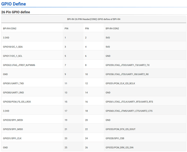

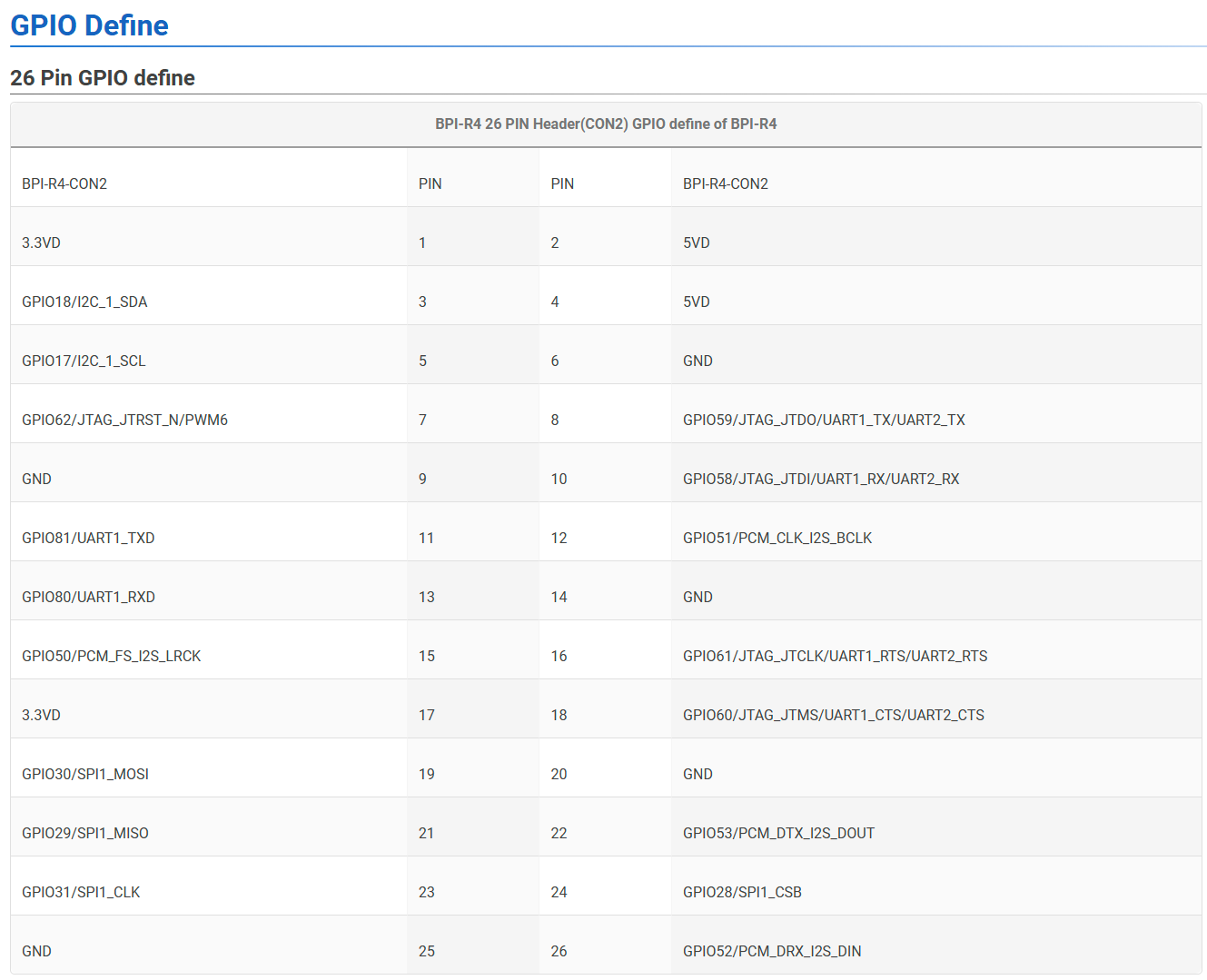

I don’t know enough about the current capabilities of the gpio pins, but the header by the power input may be a better choice. The 4-pin header provides both 12v and 5v, thats what I powered my fans from.
I have 2 fans that can run on 5V or 3.3V.
Enough pins to choose from:
