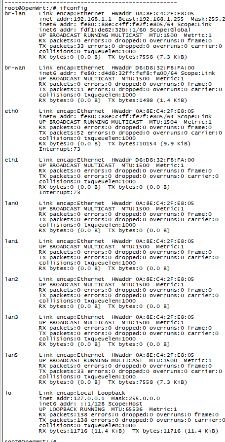

To view current IP addresses: Enter the ifconfig command in the console.

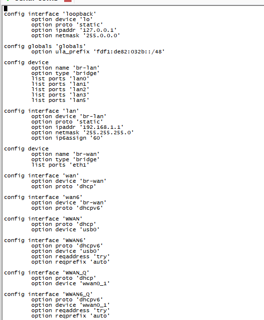

Modifying IP address (192.168.1.1 → 192.168.10.1):
  1. Edit the network configuration file in /etc/config/
  2. Access the file via SSH using:
  1. Press i to enter edit mode. Modify the IP address, subnet mask, default gateway, etc.
  2. After editing:
  • Press Esc to exit edit mode
  • Type :wq then press Enter to save and exit

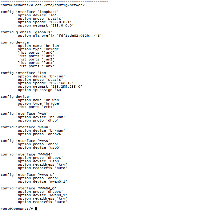

  1. Verify changes with:
