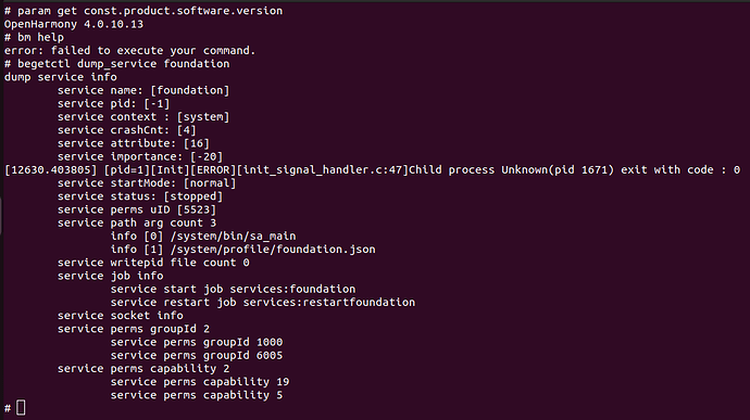

Issue: The bm command fails with: error: failed to execute your command
The below screenshot shows the bm command execution failure on the target platform.

Using the RPI v4.1 reference, we observed that bm works only when the foundation service is running. When the foundation service is manually stopped on RPI v4.1, bm also stops working.
