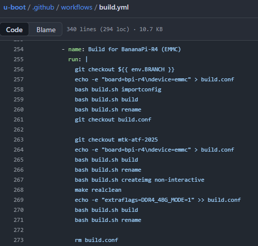

According to the workflow, I’ve generated the below images/pack
bpi-r4_emmc_8GB_bl2.img
bpi-r4_emmc_8GB_fip.bin
bpi-r4_emmc_bl2.img
bpi-r4_emmc_fip.bin
bpi-r4_emmc.img.gz
this pack supports 4GB and/or 8GB?
Linux
No needs to adjust the DDR size, right?
frank-w
(Frank W.)
2
As you see in pipeline the createimg is called before the 8BG flag is added,so it is 4gb only…you have to replace bl2 in the image with the 8G bl2
brucerry
(bruce)
3
So if I set extraflags=DDR4_4BG_MODE=1 before the build and createimg, it should build and pack for 8GB?
frank-w
(Frank W.)
4
Yes, then the 8gb will bebuilt and included in the image
