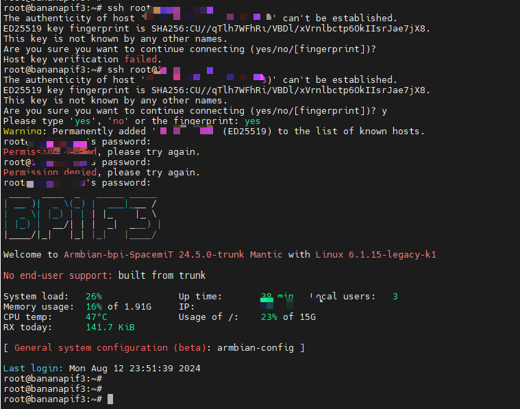

You can try using the network port-based SSH to control the board instead. The IP address acquisition can be done on the upper-level router.
However, I’m not sure if the USB interface of the board or the serial port cable is broken. You can try replacing the cable and the PC connection and see if it works.
Well, I’m very sorry to hear this. However, you can contact the official customer service for factory repair. This should be a hardware issue with the board.
