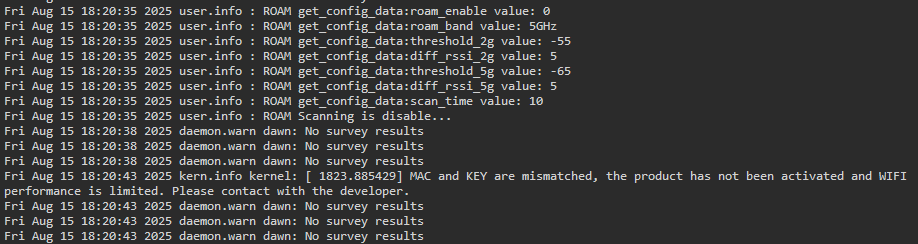

I’ve complied the new one and updated my own device and although it’s still 22.03, the version is now TGP 3.3.4 instead of the old 3.1.0. But when I checked the logs I found out this weird line:
Fri Aug 15 18:20:43 2025 kern.info kernel: [ 1823.885429] MAC and KEY are mismatched, the product has not been activated and WIFI performance is limited. Please contact with the developer.
This will be logged every 5 minutes, seems like BananaPI has implemented a check for the device, I couldn’t find any docs about how to activate this so I’m waiting for the devs to solve this.

The new repo you found returns a 404 at this time.
Just checked and it was taken down for real, let’s hope BananaPi would do something on this. The original firmware on 160mhz allows me to get the nice gigabit wi-fi speed but the build itself is kinda unfriendly to work on, the new firmware fixes some stuff, but lacks speed and still unfriendly to compile (for some reason the generated .json file of the built firmware doesn’t have any compiled kmod packages info as list to let me use and host my own kmod repo and install packages like in official openwrt firmware)
