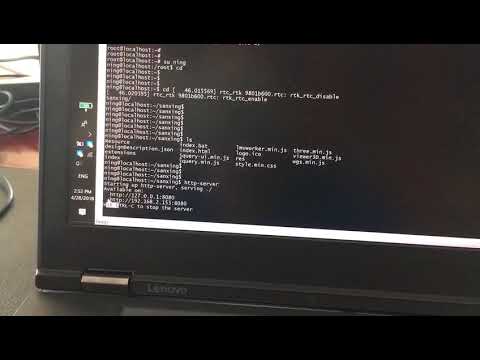

After running Ubuntu 16.04, it’s easy to install packages on the W2. Please follow below steps to install node.js:
1.  apt-get install nodejs
2.  apt-get install npm
3.  npm install -g http-server
4. make a link to nodejs:  cd /usr/bin/; ln -sf nodejs node
then Node.js is ready on your system.
As a demonstration, I copied a 3D model to the W2 and displayed it with http-server. It runs very smoothly. Please refer to the video link below.
