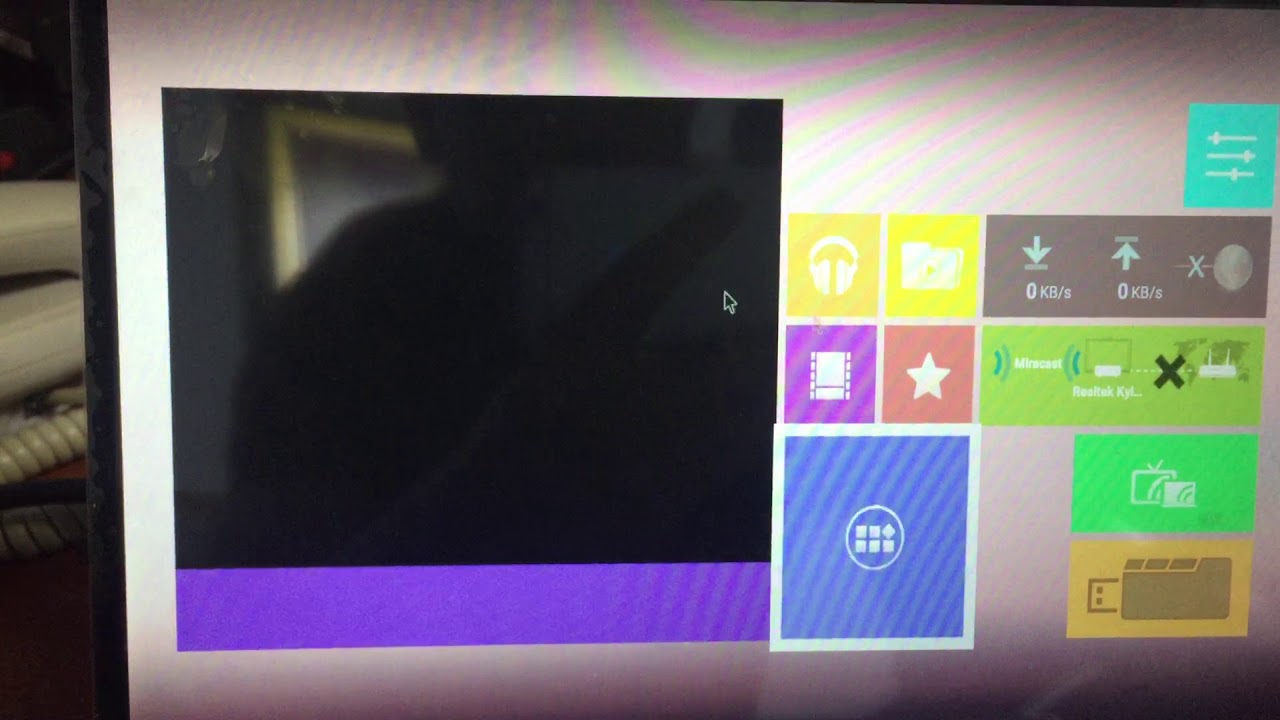

Thank you for your help. My BPI-W2 is running Android 7.1.1. But now there are a few questions that need to bother you:
  1. The power-on system of W2 development board starts by itself. When it needs to be shut down, the power key is invalid and can only be pulled out. How can I use the power key to shut down the system?
  2. How to set and enable the infrared function of W2 development board?
  3. The PCIe2.0 slot of W2 development board installs RTL8822BE WIFI and Bluetooth integrated network card, but WIFI works normally, Bluetooth display has been disabled and can not be activated.
  4. The LAN port of W2 development board does not work.
Can you tell me how to operate or set it up in detail? I look forward to your reply. Thank you very much.
