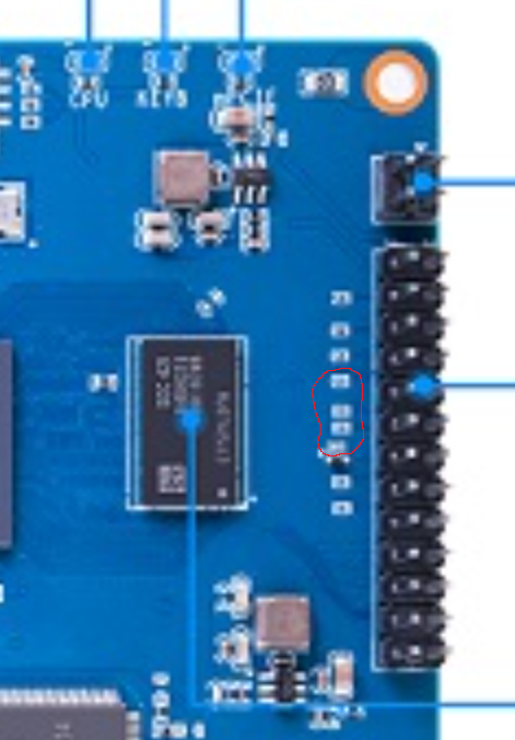

btw should I bridge these pads in red and use jtag from gpio header? I also have xgecu t48 and ch341a.

Yes, but the jtag and pcie functions are reused, so some changes need to be made
Okay thanks! I’ll try the image now. What changes do you mean, is there something I can do?
