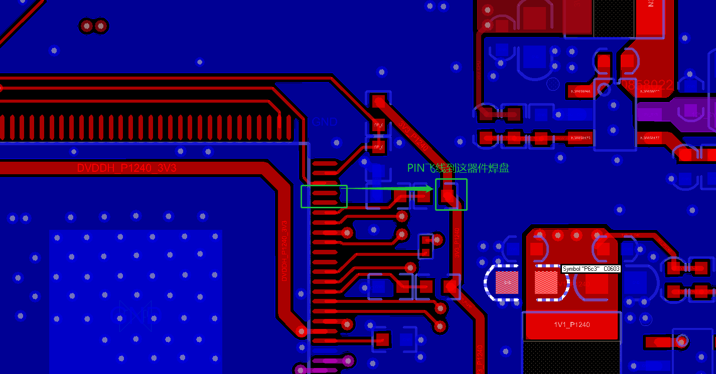

Which pin needs to be pulled up? (with respect to BPI-RV2-V11-SCH-20241121.pdf)

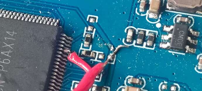

Details of the welding points are as follows:

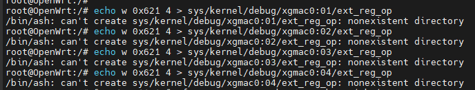

Then, you also need to enter the following command: 87bb8231184a44bdd90e2bd52926ea85
Try this kind of modification.
Thanks! I’ll try this.
(I guess writing 4 to reg 0x621 can be also done in the siflower phy driver)
Edit: according to schematics (page 17), this is pin 29 (RESV_CFG_0) pulled-up to 3v3.
I guess pin 31 (GP_0) should not be pulled down? i.e. R268 needs to be removed?
By the way, this resistor needs to be moved further upwards.
This is R268, yes.
But why pull-up GP_0? it’s the drain of eth0’s green LED; it seems you need to have it floating.
