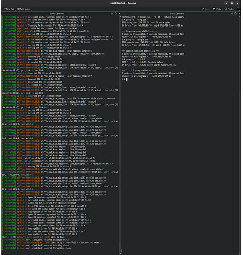

I need to figure out the correct configuration for nft because as you can see from the command I am running below and in the screenshot, it is using --network host:
root@OpenWrt:~# docker run --rm -it --network host alpine
/ # ping -c 1 bing.com
PING bing.com (150.171.28.10): 56 data bytes
64 bytes from 150.171.28.10: seq=0 ttl=120 time=1.100 ms
--- bing.com ping statistics ---
1 packets transmitted, 1 packets received, 0% packet loss
round-trip min/avg/max = 1.100/1.100/1.100 ms
/ # ping -c 1 google.com
PING google.com (142.250.140.113): 56 data bytes
64 bytes from 142.250.140.113: seq=0 ttl=114 time=1.469 ms
--- google.com ping statistics ---
round-trip min/avg/max = 1.469/1.469/1.469 ms
/ # ping -c 1 1.1.1.1
PING 1.1.1.1 (1.1.1.1): 56 data bytes
64 bytes from 1.1.1.1: seq=0 ttl=57 time=1.455 ms
--- 1.1.1.1 ping statistics ---
round-trip min/avg/max = 1.455/1.455/1.455 ms
As you can see it is running OCI (Docker) containers just fine without dmesg showing any errors.
