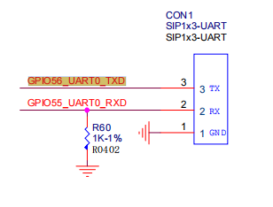

Did you manage get connected to DEBUG port in recovery mode? Perhaps we can put this aside first.

Nope it was plain vanilla openwrt, no custom kernel and unfortunately uart still doesn’t work

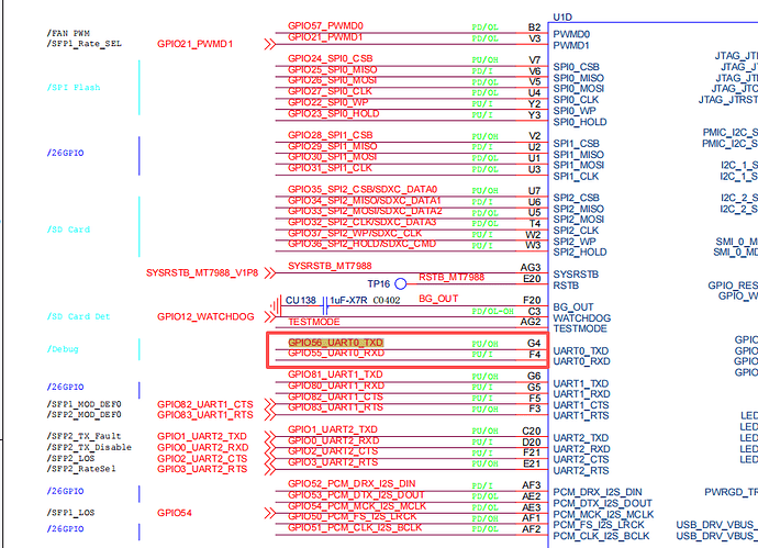

Very weird in your case. Perhaps it has to do with the DEBUG port. Kernal can’t initialise it in early boot and revert back to recovery mode.
I would check on your R4 if any short circuits on the DEBUG port…

Its serial port cable was directly connected to the CPU. Perhaps it is related to the static electricity mentioned by Kvic, which directly caused the serial port function of the CPU to be damaged.
Tried using the uart 1 etc and all I get is garbled junk with that
Other uart has to be configured to use as debug port and even when setting speed in cmdline it was still 9600 in my basic tests
Afaik @rmandrad did some further tests with uart1/2 here but also needs change in pinctrl and dts
