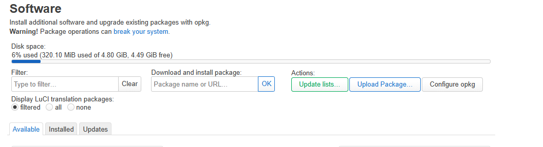

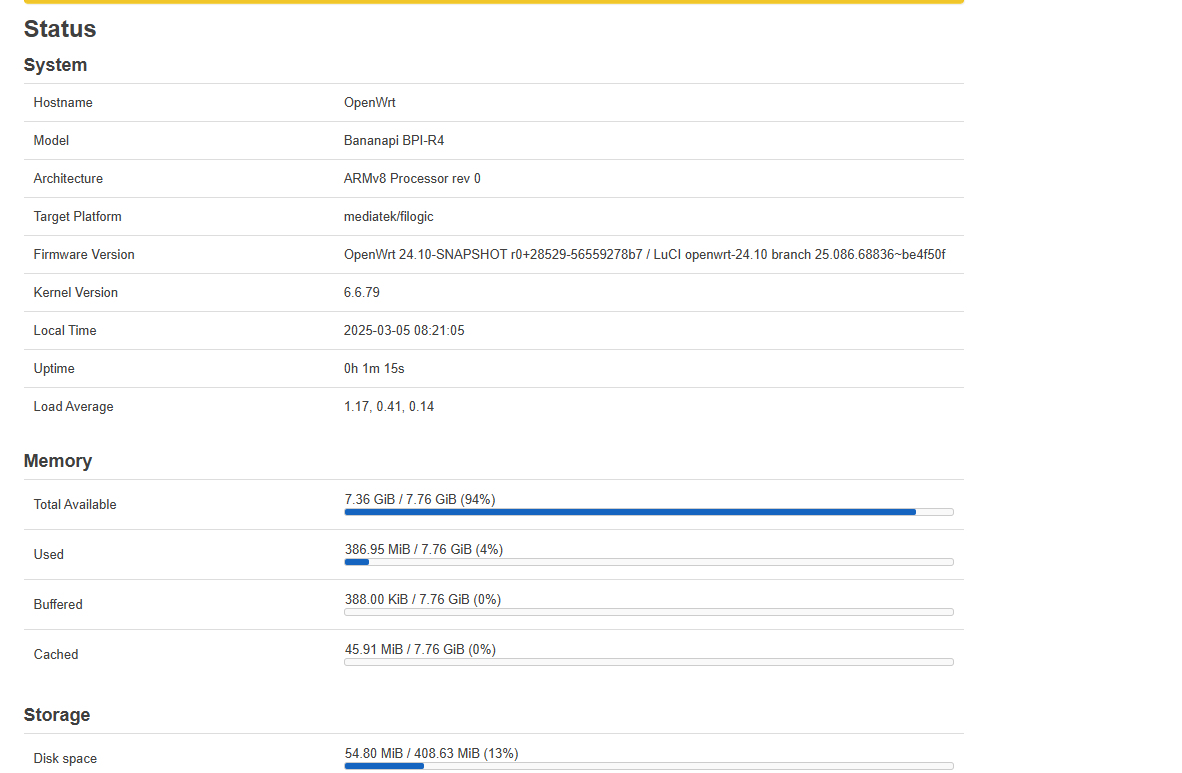

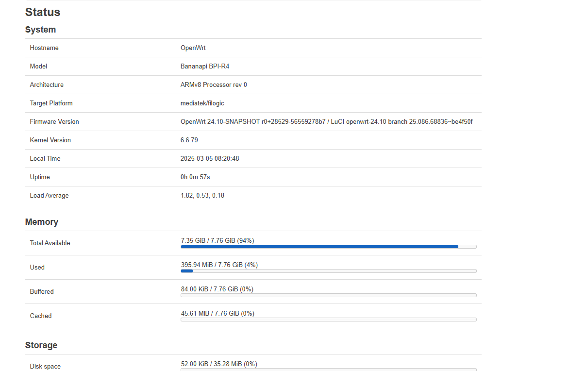

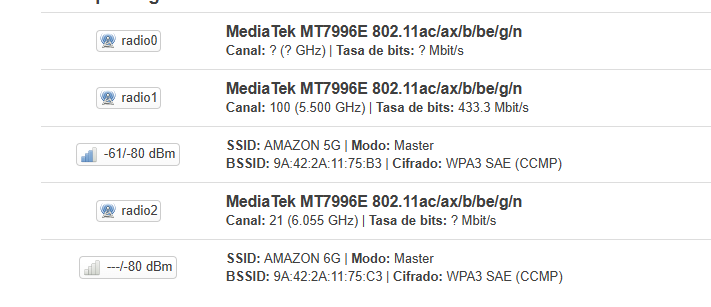

Good morning, @Phelan_Ward_Kell I used your SD card image. I was able to use all the bands, but only with the country shown in the image. If you change countries, some bands stop working. With yours, only the one shown in your image is valid for the country indicated.
I changed it for mine, and all the bands worked, but the rest worked fine. It recognized the 8GB on the SD card without any problems.

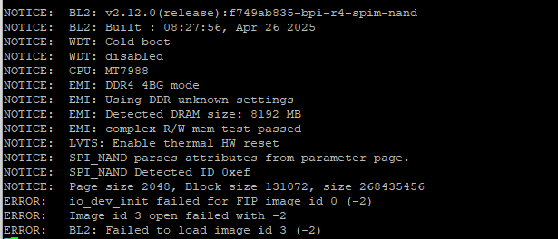

Then I recorded directly from the SD card to the NAND. Here’s the problem: when you boot, it says ā€œfailedā€ and won’t boot on the NAND. I’ll give you the error message that appears when you try to boot from the NAND.
nand no ok
I have used all your u-boot in your repertoire and they are valid, it recognizes in my image that I used for the 4gb nand, now it recognizes the nand as 8gb, but when recorded directly from the sd, it gives some corrupted blocks, but then when it starts again everything comes out perfect and it recognizes the 8gb nand, without any problem, if the first blocks bother someone I advise you not to use it but it works perfectly I leave the complete log so that the erroneous blocks can be seen, but then once they finish it starts to boot with the menu in nand, recognizing the 8gb.

I’m posting the image from the NAND, as if it recognizes 8GB.
Then I downloaded CFDisk from the NAND flash drive and installed it.
Once installed, we run cfdisk /dev/mmcblk0 and I’ve given it more space in eMMC so we have more gigabytes to be able to install everything we want since I have both the 4GB RAM and the 8GB RAM. This space exists and is the same on both boards and is unused. Once we run the command, a screen like this will appear.
mmcblkOp5
In free space, in green, you’ll see 7.2GB free. This, which is unused on both boards, we’ll give to eMMC.
We’ll search for dev/mmcblk0p5 and go to resize. We’ll delete the 7.2G. I put 5G. You have to enter it that way for it to recognize it. We’ll press Enter. Then we’ll go to the write tab and it will ask you to confirm with yes. Write it, and that’s it! That’s it!
Now we’ll reboot into NAND, but when the menu appears, we’ll click on install in EMMC. However, once you reboot, you’ll see that those 5 GB still don’t appear in the software, which is where they should appear. However, this is normal since we’ve already recorded the NAND image. Now you can install your OpenWRT-MediaTek-Filogic-Bananapi_bpi-r4-Squashfs-SysUpgrade.itb from EMMC. Once you reboot, the 5 GB will appear, allowing you to install everything you wanted.
I leave an image with the 5GB that we have given to be able to install everything we need
Now, I’ll leave you the image I used to burn the first image to SD, which perfectly recognizes the 8 GB. This image has no errors, but it’s very simple, since we want it to be the base for burning it to NAND, since the NAND doesn’t have much space, so you can’t do much.
Here’s an image of the 8GB of RAM recognized by the SSD.
SD card image
sd-nand-8gb-ram
Here’s the image I used in EMMC to update Kernel 6.6.86 in case anyone wants to try it. It’s not mine, it’s from my colleague @RafalB82.

nand no ok
This error appears when you boot your image from the NAND and it does not advance, it remains stopped,
Regarding Wi-Fi, it only works correctly in the country your image is in. If you change countries, some bands stop working.
The 6G in your image doesn’t work at first, but by adjusting the parameters within Wi-Fi without making any changes using your regulatory.db, I finally got it to work. The maximum power was 20 dBm on all 3 bands.
When you change countries, it dropped to 5 dBm or 7 dBm; I don’t remember which of the two it was on the bands that were working.
Normally, when you change countries, only one band worked, and it was random.
That’s when I installed mine, and of course it’s not the official one; it works in all countries and all bands, but always at maximum power.
What I didn’t notice was the signal/noise ratio on yours. I’ll post a picture of mine. I only enable it for Amazon since I work with VPN, and I only have public IP Wi-Fi since Amazon requires it to view it. My Wi-Fi on the Banana is disabled the rest of the day.

Regarding my image, I used your u-boots to mount mine. It works fine on SD, and it also works for writing to NAND, as I showed you, and writing from NAND to eMMC.
With yours, when writing from SD to NAND, it didn’t work when booting, and I don’t know why.
