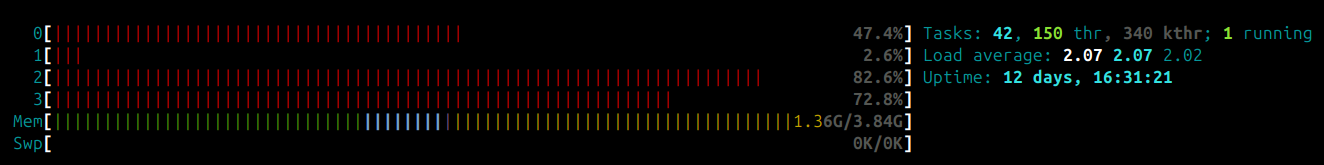

It is not related to the RSS/LRO, but as I am testing everything on nvme or raid arrays, and next tests only on this raid 6 array from these days, I would like share with everyone interested thinking about using bpi-r4 as its own nas. Here is the on-going re-check performance of my raid6 array:
$ cat /proc/mdstat
Personalities : [raid4] [raid5] [raid6]
md127 : active raid6 sde[4] sdf[6] sdd[2] sdb[5] sdc[0] sda[1] sdg[7]
      14650675200 blocks super 1.2 level 6, 512k chunk, algorithm 2 [7/7] [UUUUUUU]
      [==============>......]  check = 74.8% (2193851400/2930135040) finish=117.3min speed=104553K/sec
      bitmap: 0/22 pages [0KB], 65536KB chunk
I have to say, that (as I created the array about more than 10 years ago) the array have probably NOT well optimalised stripe and stride, therefore performance of re-sync and working in degraded mode is lower. But I think that re-check is going quite fine.
Loadavg is about 2:
And kernel info:
$ uname -a
Linux nas 6.16.0-rc1-bpi-r4-rsslro #1 SMP Wed Aug 13 11:33:51 CEST 2025 aarch64 GNU/Linux
