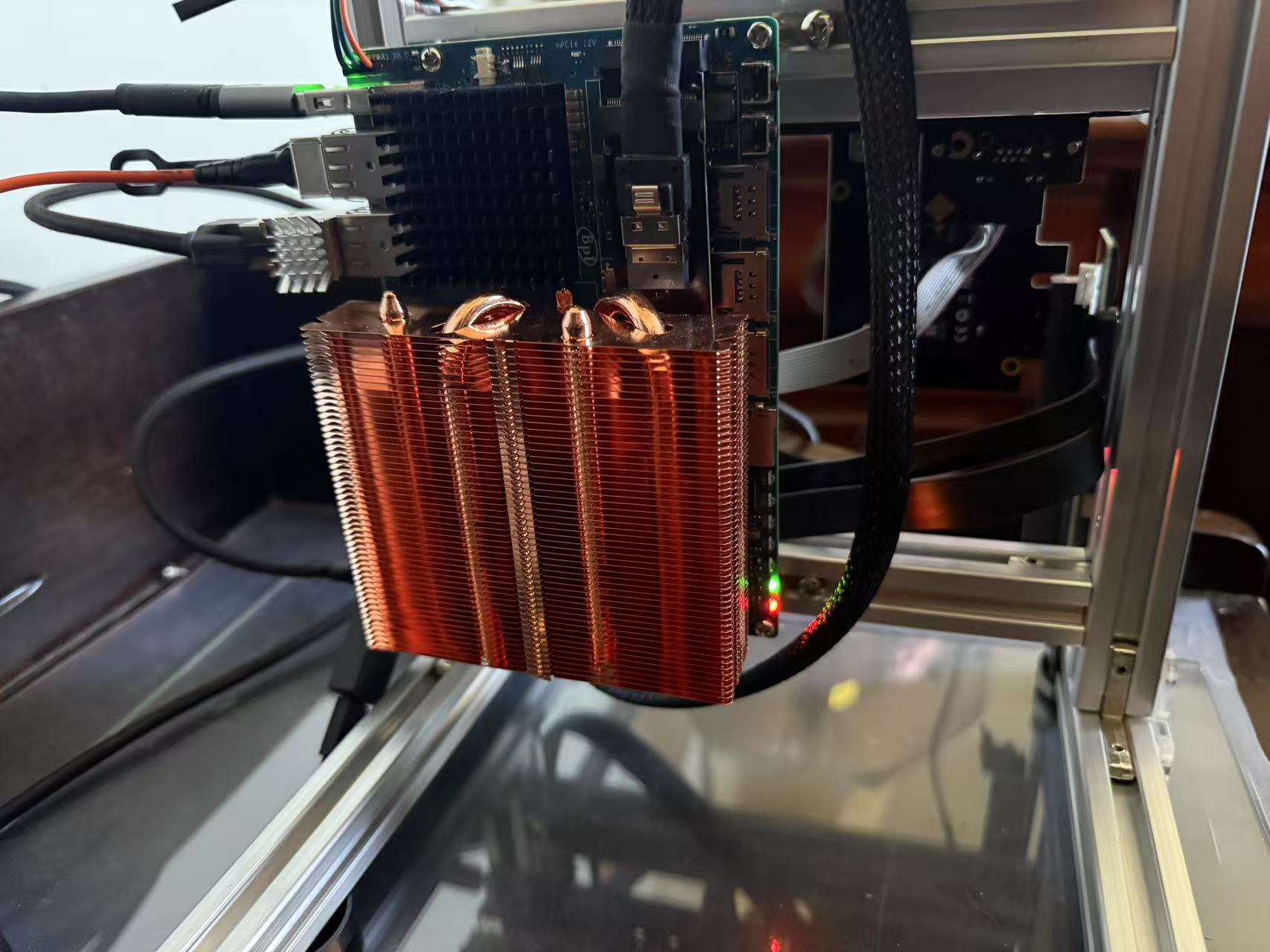

Using a 5mm thick 50x50mm pure copper plate combined with the Thermalright AXP-90 X47 Full Copper heatsink, the BPI-R4 runs completely fanless. The CPU temperature consistently stays below 33°C at an ambient room temperature of 20°C.
close the case and do those tests again. i doubt they will stay that low.
