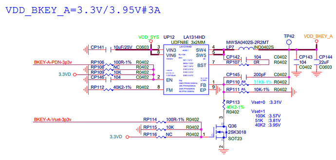

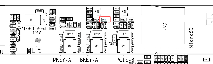

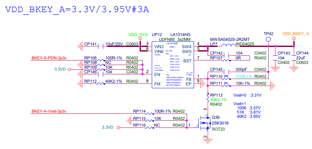

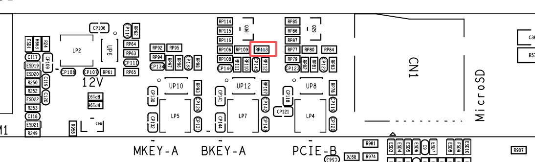

I’m looking to increase the power to my 5G modem to 3.95V but not being versed in GPIO I’ve been having a hard time figuring out what pin needs writing to in order to increase the voltage for CN15. Any help is appreciated.
