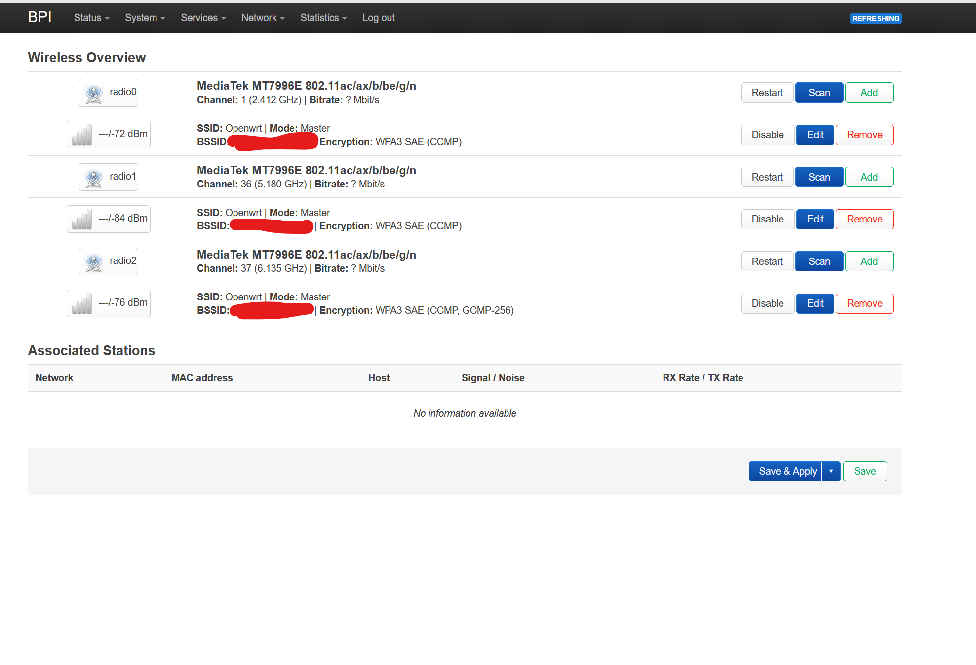

I set one wifi-name on all wi-fi AP. And set WPA3 SAE (CCMP). How can i test that i use MLO/MLD?

Has anyone got MLO working on @frank-w’s PR branch (R4Pro_4E)? I’ve got the Pro 4E board, of course.
