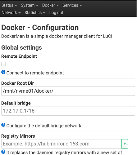

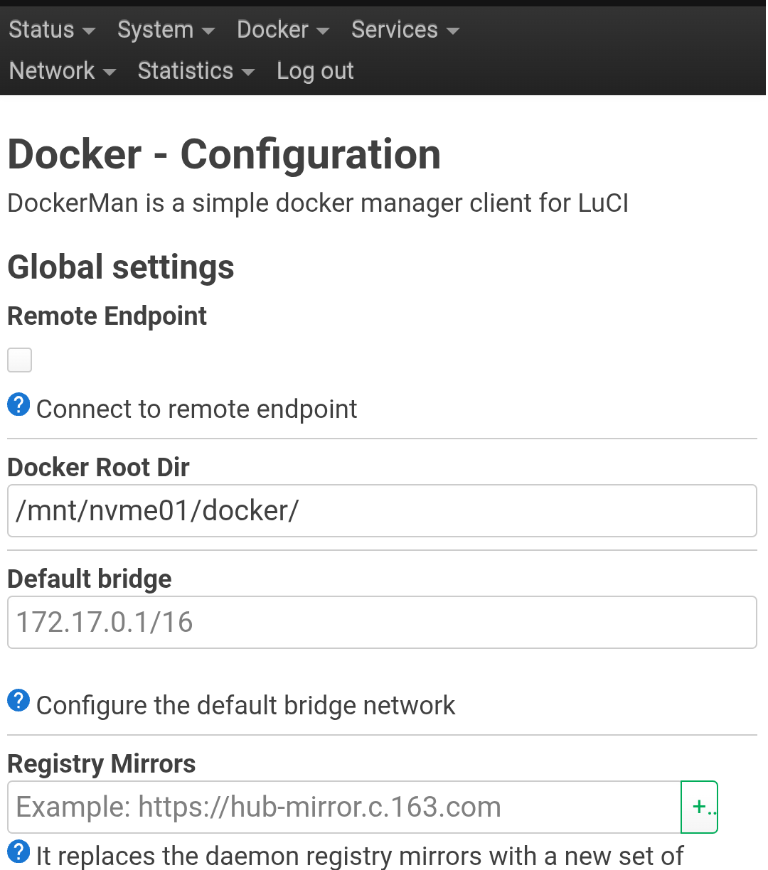

About your second point and moving docker to another mount point on OpenWrt.
I recommend you familiarize yourself with docker compose instead of Portainer. It’s easy to use and saves system resources.
