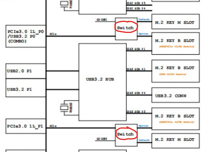

BPI-R4 Pro design with MT7988, update version for BPI-R4, any good idea?
There are some issues that need to be fixed in hardware and software before it is usable. I cannot recommend the R4Pro at this time.

Maybe @sinovoip can change this in future revisions/boards. But first hw bugs need to be fixed. please update also the diagram and the specs in first posting of this thread.
we have 4x2g5,1x1G and 2x combo (10G phy/sfp+). verified pcie including the switch (key-m/key-b) last days.
